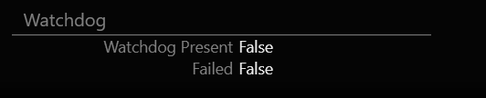

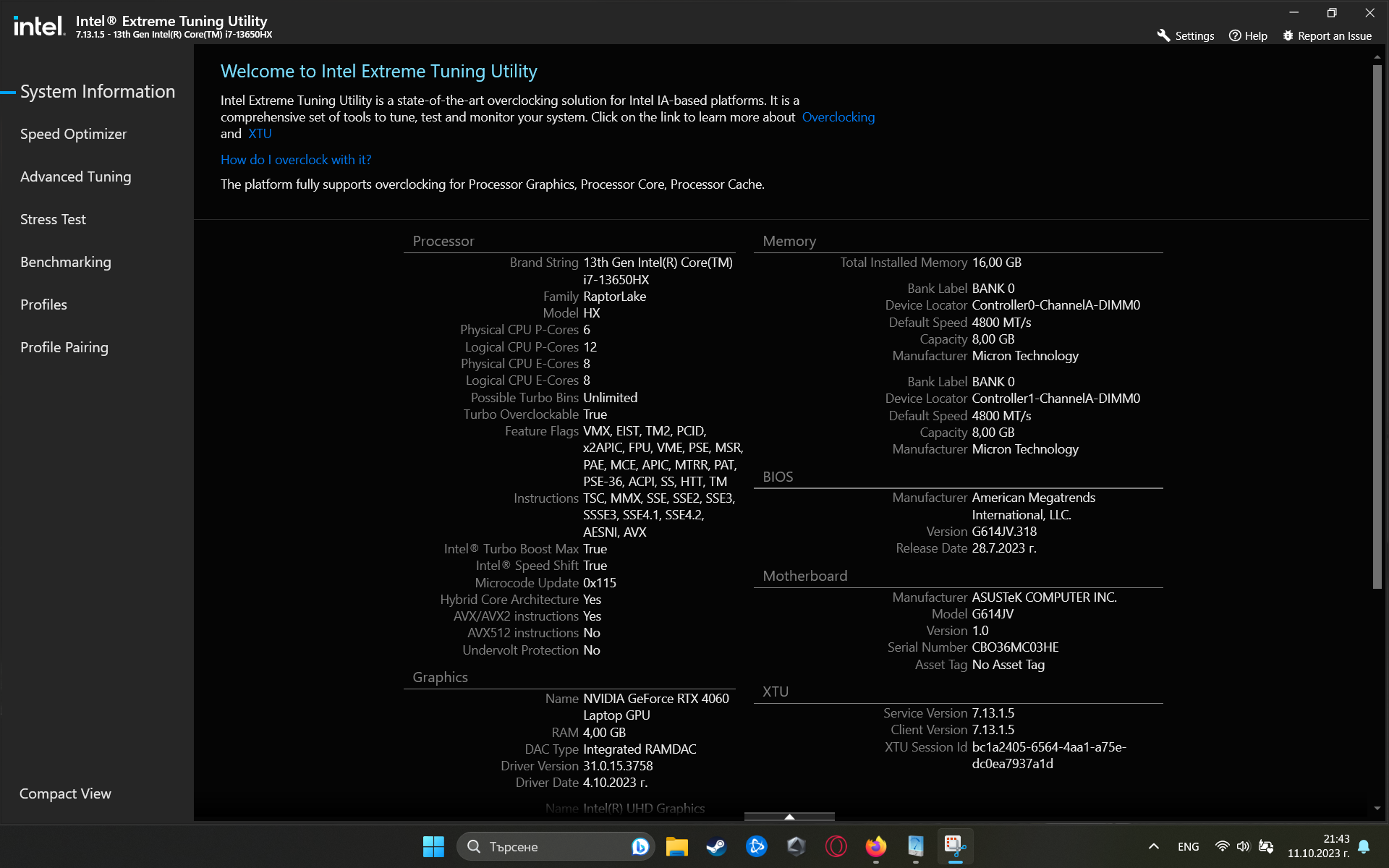

so my problem is that the Intel XTU dont restore tuning after reboot i also search in this forum i find some information but for better advice i write this post
so this is my system and this is intel xtu settings where i cant enable after booting up
i use the most recent version of Intel xtu
also i use rog strix g16 laptop whit the latest bios update from the official site

Some users with an ASUS* motherboard combined with an unlocked processor may be unable to restore profiles settings after reboot. This is because the Intel® Watchdog Timer Driver (Intel® WDT Driver) is not present in Intel® XTU. Intel® WDT Driver is responsible for the automatic Restore tuning after reboot settings. Under Intel® XTU System Information, find Watchdog section and confirm Watchdog Present shows FalseFalse means the Watchdog is not detected within the system, and the Intel® XTU user will have to manually restore settings/profiles after reboot.

·      Issue: I have Intel Extreme tuning utility installed in my laptop but why I am unable to overclock the processor?
o  Intel® Extreme Tuning Utility can be installed in laptops but it will not work for overclocking purposes. This is because overclocking with Intel® Extreme Tuning Utility only works for processors with K, KF, or X in their processor number.
o  When the tool is installed in your laptop with an unsupported processor, the user can view system information parameters such as processor information and motherboard and BIOS info. However, using the tool to change parameters in your laptop such as core voltage can result in inconclusive and unreliable behavior due to an unsupported processor.
As your CPU is within the supported range, kindly furnish us with all the necessary details beforehand to facilitate its validation by the responsible team.

Hello again thanks for the response and the help i am sure thats my problem is in asus motherboard becouse my laptop is Asus Rog Strix G16 and from the screenshot that i see for Watchdog presents my is false false false so i am sure where is the problem becouse my system is new i have latest bios update and i7-13650HX
