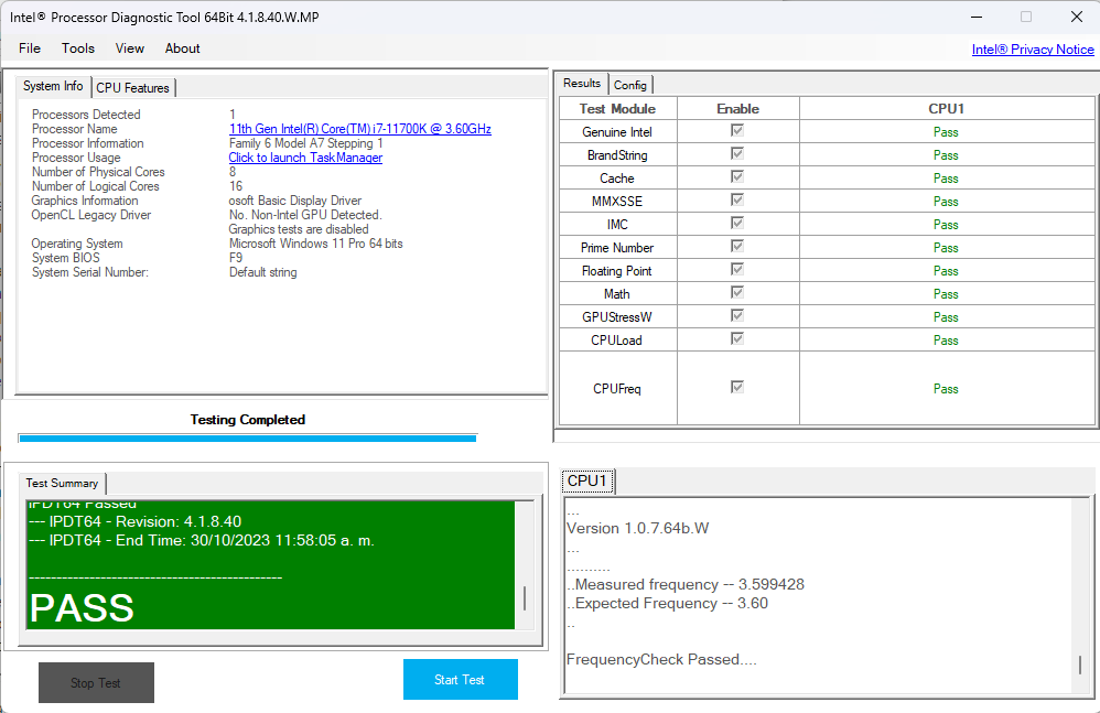

Furthermore, I have run the Intel Processor Diagnostic Tool
Ref. TESTRESULTS.TXT
Ref. TestResults_Full.txt
