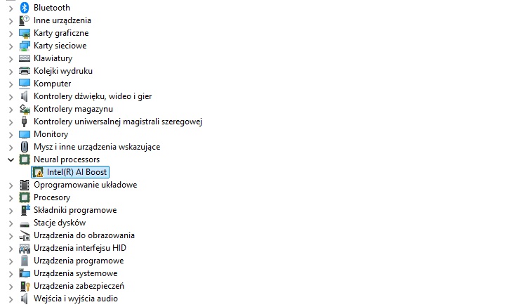

Good Morning,
I have a problem installing the Intel AI Boost driver, which after installation displays a driver error (code 43).
I noticed that the problem occurs when switching the Corsair Vengeance CUDIMM DDR5 8000tm CL38 CMHC48GX5M2X8000C38 memory mode to the XMP profile. When i disable the profile and the memory switches from 8000tm mode to the standard 5600tm mode, everything works fine. How can I solve this problem? i would like to mention that this problem does not only occur on the above Corsair boards, but also on others. The processor i have is an Intel Core Ultra 7 265KF and MSI Z890 Gaming Plus WiFi. Even after enabling the XMP profile and correctly installing the driver, AI boost does not work correctly and throws an error when trying to check the correct operation of the device. Could this be caused by a damaged or bad memory controller in the processor?

yes, the error code stops appearing as soon as I lower the memory clock speed to 7200MHz. Anything above this frequency throws an Intel AI boost driver error.
PriestHunt
40,739 Views
Hello again,
I just noticed that my motherboard manufacturer released a BIOS update, which I immediately installed. To my surprise, the NPU was working correctly without any errors at full speed with the CUDIMM memory (8000MT). I don't know what the problem was, but the manufacturer states on their website that the update includes fixes:
- Resolve problems with display settings.
- Support Intel MR3.
- Update GOP.
For now, everything is working as it should, with a noticeable performance improvement, which is a big plus...

**ERROR CODE 43 FIX FOR INTEL GRAPHICS DRIVER AND NPU INTEL AI BOOST DRIVER**
To you and all other people who suffer from this issue, I have been researching this issue on my own (I'm an IT Engineer), doing experiments, digging through event logs, uninstalling and reinstalling drivers, Windows, different versions of both, BIOS settings, etc. I even reached out to Intel at one point, but eventually I stumbled upon the answer. Now I read through many a forum, and webpage, reading through all the things people wanted to check, or have done, etc. and this issue seems to plague mostly anyone using an Ultra series Processor. Doesn't matter the RAM type, or speed, or whether AI 200S Boost is on in BIOS, on any Z870 or Z890 chipset motherboard (no matter the manufacturer, ASUS, MSI, Etc.), etc. It all boils down to one issue, with the error code 43 for both the IGD (Integrated Graphics Driver), and the NPU, or Neural Processor for Intel AI Boost driver. This will fix both issues in one go, if your drivers are installed and up to date.
Perform the following in your BIOS settings:
**Note**
Make sure you are in the advanced tab by pressing F7 on your keyboard, before trying to find the following:
Go to the Advanced Tab on the top of your UEFI Screen.
Then Platform Misc Configuration, which you should see the following:
PCI Express Native Power Management = Enable this
Native ASPM = Enable this
