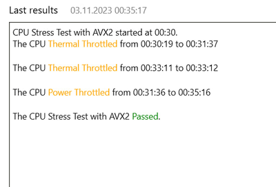

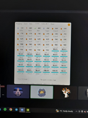

Hello! bought intel core i9 13900kf 9 months worked perfectly, recently it started getting very hot (I changed the thermal paste) It got to the point where it heats up to 100C and just turns off. I want to get service so that you can either repair the processor or replace it, what do I need for this? I live in Ukraine.

Thanks for confirming the information asked for. Based on this issue, I would like to gather the following details to better assist you:
1. Run and attach the report from the Intel® Processor Diagnostic Tool:
2. What is the brand and model name of your motherboard?
3. What is the BIOS version installed?
4. What is the brand and model name of your cooling solution (fans)?
5. Where are you seeing these temperatures (task manager, Intel® XTU, 3rd party tool)?
6. Can you take a picture of the temperatures you are getting?

--- Genuine Intel Test ---

Operation Per Second -- 3758006
Error -- 0
Prime Number Generation Test Passed
Module Math_PrimeNum.exe Completed - Pass
Result - Pass

ASUS ROG STRIX Z790-A GAMING WIFI
BIOS 1501 version
aorus waterforce x240 (maximum solution)
i use speedfan program
Elladier
12,831 Views
1. Txt file
2. Asus rog strix z790-A GAMING WIFI
3. Bios last version 1501
4. Aorus Waterforce x240 (max speed)
5. SpeedFan,  Intel® XTU doesn’t work in my PC, when i click in "test my system" (Programm crashed)
6. Yes
DeividA_Intel
12,765 Views
Hello Elladier,
Thanks for the report and the information provided. In this case, your processor supports up to 100°C and any temperature below it is normal and expected. From your picture, I can see that your temperature is 55°C-77°C and some cores seem to be at 100% usage, but this could be expected depending on the tasks/background app running at the moment.
1. Can you take a new picture of the temperatures where I can see them at 100°C?
2. What is the name of the tool you used to measure these temperatures? The one you show in Discord.
3. Did you test with a different CPU, maybe at the place of purchase tech team?
Deivid A.

Elladier
12,580 Views
I ran the test for 5 minutes, here are the results:
DeividA_Intel
12,517 Views
Hello Elladier,
Thanks for the confirmation. This will help with the investigation and I will get back to you as soon as possible with more details.
Deivid A.
