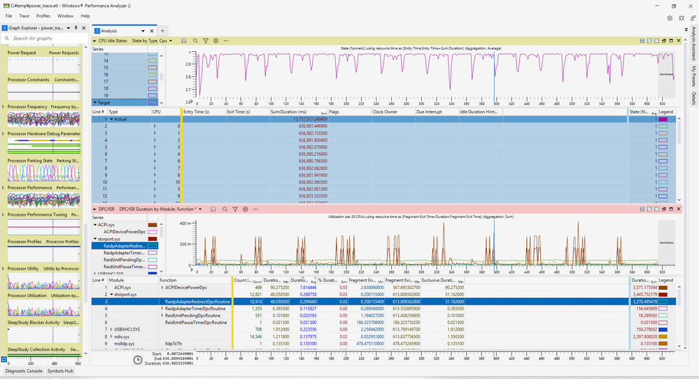

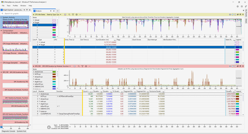

- WPA Trace Evidence
Evidence 1: C1E Transition Failure The CPU fails to transition to the Target State (C1E / State 2) during the screen-off event.
Evidence 2: 90ms DPC Latency Consistent ~90ms duration recorded for the ACPI DPC.
Evidence 3: Empty Call Stack (Spin-wait) Empty stack trace suggests the CPU is stalled in a serialized polling loop.
- Root Cause Analysis (ACPI Table Inspection)
Preliminary analysis of the DSDT suggests the latency is driven by a specific polling loop within the HID device transition logic. The implementation uses a While loop combined with Sleep(0x04) (4ms), waiting for an Embedded Controller (EC) status flag.
The observed 90ms duration perfectly aligns with approximately 22-23 iterations of this 4ms polling cycle. This serialized wait appears to prevent the CPU from completing the C1E (State 2) transition.

To assist your analysis, I can confirm that this issue is 100% reproducible on a clean Windows 11 25H2 installation by triggering a screen-off event every 60 seconds. All attached screenshots were captured under this automated condition across multiple identical systems.
Observed behavior includes consistent ~80–90 ms DPC spikes in ACPI.sys (ACPIDevicePowerDpc), aligned precisely with display power state transitions. In addition, Intel iaLPSS-related drivers (GPIO/I2C) appear in the DPC stack around the same timing.
While organizational policy prevents sharing raw .etl files, I would be happy to provide additional WPA views or specific breakdowns if helpful.
I would appreciate any insight into whether this behavior aligns with expected C-State transition behavior on Raptor Lake-S platforms, or if further tuning/firmware considerations may apply.

I have also attached a WPA capture from a clean test unit after updating to the latest BIOS and chipset drivers.
The same pattern of repeated DPC/ISR spikes (involving ACPI.sys and storport.sys) is still clearly observed during idle / screen-off related periods.
C-state behavior (important):
Disabling C-state control does not resolve the issue but instead redistributes latency to other drivers (e.g., storport.sys), resulting in less deterministic but still degraded behavior.
