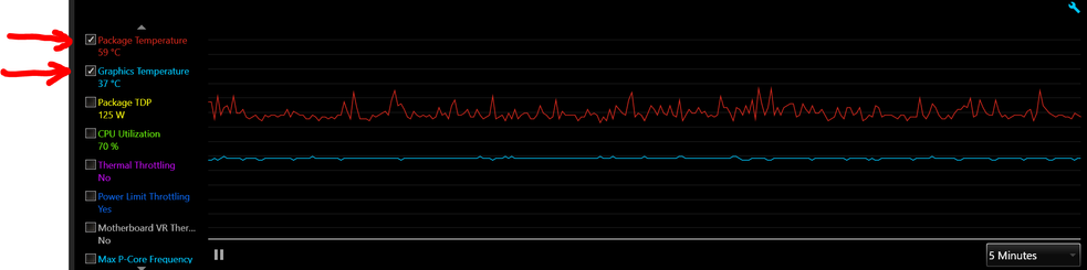

"none of the temperature sensors will match IHS temp when under load"
This will stay true, even 2 or 3mm in distance may result in high difference in temperatures, as the die has been made thinner on the 12gen onwards.
Proof:
None of the temperatures is as low as the unused grahpics on the CPU....bcoz that temperature is literally IHS temp.

This here is apparently  i7 13700k which i use, the physical size is about 24mm x 12mm (1inch x 0,5inch?), so a Pcore would have a physical size of about 3mm x 4mm, for what i care, the temperature sensing resistor - has exactly that size, and if that is the case, the whole surface under the Pcore is sensing temperature.
There is nothing else there.

i have tried and testing my 12700K at 125-253-307 and of course 253-253-307.
KrissyG
New Contributor II
15,506 Views
yes, that with 125W got me too, i was not expecting the CPU to draw more than twice as that, and that without OC.
For my own use, 125W actually hits the sweet spot, as the CPU at 250W does only few % more performance in the applications i use, therefore the TDP limit is always at 125W.
Just when i replace the thermal paste, i set it to unlimited and if i see the CPU hitting 300W on a stress test = succesfully applied thermal paste and succesfully mounted water block.
