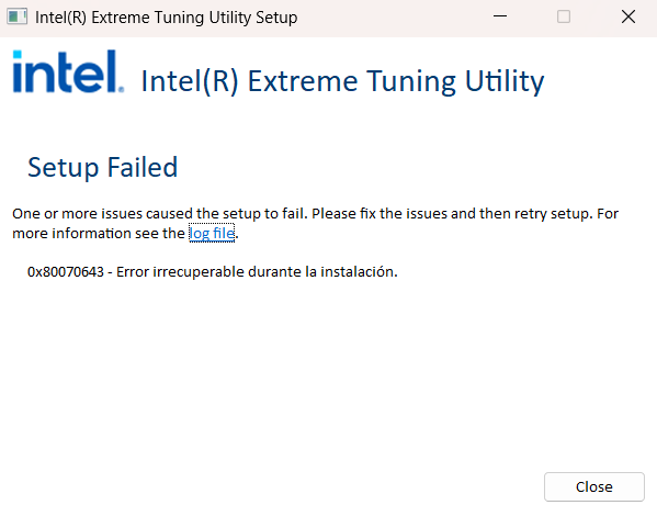

vuelvo a abrir este hilo porque sigo sin poder instalar XTU.
LOG FILE :
[1CE4:37A4][2025-02-11T18:19:18]i001: Burn x64 v4.0.5+b9b2f1b4c69a1b509d487dc950b30b4ec9b0d040, Windows v10.0 x64 (Build 26100: Service Pack 0), path: C:\Users\carlo\AppData\Local\Temp\{E4531C2B-AF3E-429A-86A5-C7AC81FCBFDC}\.cr\XTUSetup_10.0.1.18.exe
[1CE4:37A4][2025-02-11T18:19:18]i000: Initializing version variable 'VCRUNTIME_VER' to value '14.40.33810.0'
[1CE4:37A4][2025-02-11T18:19:18]i000: Initializing version variable 'BundleVersionNumber' to value '10.0.1.18'
[1CE4:37A4][2025-02-11T18:19:18]i009: Command Line: '-burn.clean.room=C:\Users\carlo\Desktop\Overclock\XTUSetup_10.0.1.18.exe -burn.filehandle.attached=688 -burn.filehandle.self=692'
[1CE4:37A4][2025-02-11T18:19:18]i000: Setting string variable 'WixBundleOriginalSource' to value 'C:\Users\carlo\Desktop\Overclock\XTUSetup_10.0.1.18.exe'
[1CE4:37A4][2025-02-11T18:19:18]i000: Setting string variable 'WixBundleOriginalSourceFolder' to value 'C:\Users\carlo\Desktop\Overclock\'
[1CE4:37A4][2025-02-11T18:19:18]i000: Setting string variable 'WixBundleLog' to value 'C:\Users\carlo\AppData\Local\Temp\Intel(R)_Extreme_Tuning_Utility_20250211181918.log'
[1CE4:37A4][2025-02-11T18:19:18]i052: Condition 'VersionNT >= v6.1' evaluates to true.
[1CE4:37A4][2025-02-11T18:19:18]i000: Setting string variable 'WixBundleInProgressName' to value ''
[1CE4:37A4][2025-02-11T18:19:18]i000: Setting string variable 'WixBundleName' to value 'Intel(R) Extreme Tuning Utility'
[1CE4:37A4][2025-02-11T18:19:18]i000: Setting string variable 'WixBundleManufacturer' to value 'Intel Corporation'
[1CE4:3434][2025-02-11T18:19:18]i000: Setting version variable 'WixBundleFileVersion' to value '10.0.1.18'
[1CE4:3434][2025-02-11T18:19:18]i000: Setting numeric variable 'WixStdBAShowVersion' to value 1
[1CE4:37A4][2025-02-11T18:19:18]i100: Detect begin, 2 packages
[1CE4:37A4][2025-02-11T18:19:18]i000: Product or related product not found: {823C3D41-1C6E-4ECA-9923-1200278AE478}
[1CE4:37A4][2025-02-11T18:19:18]i000: Setting version variable 'MsiAlreadyInstalledVersion' to value '0.0.0.0'
[1CE4:37A4][2025-02-11T18:19:18]i000: Setting string variable 'NETFRAMEWORK45' to value '533320'
[1CE4:37A4][2025-02-11T18:19:18]i000: Setting version variable 'VCRUNTIME_X64_VER' to value '14.42.34433'
[1CE4:37A4][2025-02-11T18:19:18]i000: Setting version variable 'WindowsDllVersion' to value '10.0.26100.2033'
[1CE4:37A4][2025-02-11T18:19:18]i052: Condition '(VCRUNTIME_X64_VER >= VCRUNTIME_VER)' evaluates to true.
[1CE4:37A4][2025-02-11T18:19:18]i101: Detected package: vcredist_64.exe, state: Present, cached: No, install registration state: (permanent), cache registration state: (permanent)
[1CE4:37A4][2025-02-11T18:19:18]i101: Detected package: Intel_XtuInstaller.msi, state: Absent, cached: No, install registration state: Absent, cache registration state: Absent
[1CE4:37A4][2025-02-11T18:19:18]i052: Condition 'BundleVersionNumber > MsiAlreadyInstalledVersion OR BundleVersionNumber = "0.0.0.0" OR NOT WixBundleCommandLineAction = 6' evaluates to true.
[1CE4:37A4][2025-02-11T18:19:18]i052: Condition 'WixBundleInstalled OR WindowsDllVersion >= "10.0.14393.0" OR NOT WixBundleCommandLineAction = 6' evaluates to true.
[1CE4:37A4][2025-02-11T18:19:18]i052: Condition 'WixBundleInstalled OR NOT WixBundleCommandLineAction = 6 OR NETFRAMEWORK45 >= 528040' evaluates to true.
[1CE4:37A4][2025-02-11T18:19:18]i199: Detect complete, result: 0x0, registration state: None, cached: No, eligible for cleanup: No
[1CE4:3434][2025-02-11T18:19:19]i052: Condition 'WixStdBAUpdateAvailable' evaluates to false.
[1CE4:3434][2025-02-11T18:19:19]i052: Condition 'NOT WixStdBASuppressOptionsUI' evaluates to true.
[1CE4:37A4][2025-02-11T18:19:21]i200: Plan begin, 2 packages, action: Install
[1CE4:37A4][2025-02-11T18:19:21]w321: Skipping dependency registration on package with no dependency providers: vcredist_64.exe
[1CE4:37A4][2025-02-11T18:19:21]i052: Condition '0' evaluates to false.
[1CE4:37A4][2025-02-11T18:19:21]i000: Setting string variable 'WixBundleRollbackLog_Intel_XtuInstaller.msi' to value 'C:\Users\carlo\AppData\Local\Temp\Intel(R)_Extreme_Tuning_Utility_20250211181918_000_Intel_XtuInstaller.msi_rollback.log'
[1CE4:37A4][2025-02-11T18:19:21]i000: Setting string variable 'WixBundleLog_Intel_XtuInstaller.msi' to value 'C:\Users\carlo\AppData\Local\Temp\Intel(R)_Extreme_Tuning_Utility_20250211181918_000_Intel_XtuInstaller.msi.log'
[1CE4:37A4][2025-02-11T18:19:21]i222: Planned rollback boundary: 'WixDefaultBoundary', vital: Yes, transaction: No (default: No)
[1CE4:37A4][2025-02-11T18:19:21]i201: Planned package: vcredist_64.exe, state: Present, default requested: Present, ba requested: Present, execute: None, rollback: None, default cache strategy: Keep, ba requested strategy: Keep, cache: Vital, uncache: No, dependency: None, expected install registration state: (permanent), expected cache registration state: (permanent)
[1CE4:37A4][2025-02-11T18:19:21]i201: Planned package: Intel_XtuInstaller.msi, state: Absent, default requested: Present, ba requested: Present, execute: Install, rollback: Uninstall, default cache strategy: Keep, ba requested strategy: Keep, cache: Vital, uncache: No, dependency: Register, expected install registration state: Present, expected cache registration state: Present
[1CE4:37A4][2025-02-11T18:19:21]i299: Plan complete, result: 0x0
[1CE4:37A4][2025-02-11T18:19:21]i300: Apply begin
[1CE4:37A4][2025-02-11T18:19:21]i010: Launching elevated engine process.
[1CE4:37A4][2025-02-11T18:19:23]i011: Launched elevated engine process.
[1CE4:37A4][2025-02-11T18:19:23]i012: Connected to elevated engine.
[2088:33C0][2025-02-11T18:19:23]i358: Pausing automatic updates.
[2088:33C0][2025-02-11T18:19:23]i359: Paused automatic updates.
[2088:33C0][2025-02-11T18:19:23]i360: Creating a system restore point.
[2088:33C0][2025-02-11T18:19:23]i361: Created a system restore point.
[2088:33C0][2025-02-11T18:19:23]i370: Session begin, registration key: SOFTWARE\Microsoft\Windows\CurrentVersion\Uninstall\{B5AA72A4-C121-4265-8ED7-CACE74ECFED7}, options: 0x3, disable resume: No
[2088:33C0][2025-02-11T18:19:23]i000: Caching bundle from: 'C:\Users\carlo\AppData\Local\Temp\{502BA80C-239D-4196-8F52-ADAC17E41184}\.be\XTUUISetup.exe' to: 'C:\ProgramData\Package Cache\{B5AA72A4-C121-4265-8ED7-CACE74ECFED7}\XTUUISetup.exe'
[2088:33C0][2025-02-11T18:19:23]i320: Registering bundle dependency provider: {B5AA72A4-C121-4265-8ED7-CACE74ECFED7}, version: 10.0.1.18
[2088:33C0][2025-02-11T18:19:23]i371: Updating session, registration key: SOFTWARE\Microsoft\Windows\CurrentVersion\Uninstall\{B5AA72A4-C121-4265-8ED7-CACE74ECFED7}, resume: Active, restart initiated: No, disable resume: No
[2088:137C][2025-02-11T18:19:23]i305: Verified acquired payload: vcredist_64.exe at path: C:\ProgramData\Package Cache\.unverified\vcredist_64.exe, moving to: C:\ProgramData\Package Cache\4DB5078FDD9EB9CE00A1B6195A67C779A1D3C719DE0FBD4729ADBDAC2D8CA442\vcredist_64.exe.
[2088:137C][2025-02-11T18:19:24]i305: Verified acquired payload: Intel_XtuInstaller.msi at path: C:\ProgramData\Package Cache\.unverified\Intel_XtuInstaller.msi, moving to: C:\ProgramData\Package Cache\{61ECB082-C976-40E3-93D1-193738567B24}v10.0.1.18\Intel_XtuInstaller.msi.
[2088:33C0][2025-02-11T18:19:24]i323: Registering package dependency provider: {61ECB082-C976-40E3-93D1-193738567B24}_v10.0.1.18, version: 10.0.1.18, package: Intel_XtuInstaller.msi
[2088:33C0][2025-02-11T18:19:24]i301: Applying execute package: Intel_XtuInstaller.msi, action: Install, path: C:\ProgramData\Package Cache\{61ECB082-C976-40E3-93D1-193738567B24}v10.0.1.18\Intel_XtuInstaller.msi, arguments: ' REMOVEALLAPPDATA="" ARPSYSTEMCOMPONENT="1" MSIFASTINSTALL="7" BURNMSIINSTALL=1 REINSTALLMODE="muso" REBOOT=ReallySuppress'
[2088:33C0][2025-02-11T18:19:26]e000: Error 0x80070643: Failed to install MSI package.
[2088:33C0][2025-02-11T18:19:26]e000: Error 0x80070643: Failed to execute MSI package.
[1CE4:37A4][2025-02-11T18:19:26]e000: Error 0x80070643: Failed to configure per-machine MSI package.
[1CE4:37A4][2025-02-11T18:19:26]i319: Applied execute package: Intel_XtuInstaller.msi, result: 0x80070643, restart: None
[1CE4:37A4][2025-02-11T18:19:26]e000: Error 0x80070643: Failed to execute MSI package.
[2088:33C0][2025-02-11T18:19:26]i318: Skipped rollback of package: Intel_XtuInstaller.msi, action: Uninstall, already: Absent
[1CE4:37A4][2025-02-11T18:19:26]i319: Applied rollback package: Intel_XtuInstaller.msi, result: 0x0, restart: None
[2088:33C0][2025-02-11T18:19:26]i329: Removed package dependency provider: {61ECB082-C976-40E3-93D1-193738567B24}_v10.0.1.18, package: Intel_XtuInstaller.msi
[2088:33C0][2025-02-11T18:19:26]i351: Removing cached package: Intel_XtuInstaller.msi, from path: C:\ProgramData\Package Cache\{61ECB082-C976-40E3-93D1-193738567B24}v10.0.1.18\
[2088:33C0][2025-02-11T18:19:26]i351: Removing cached package: vcredist_64.exe, from path: C:\ProgramData\Package Cache\4DB5078FDD9EB9CE00A1B6195A67C779A1D3C719DE0FBD4729ADBDAC2D8CA442\
[1CE4:37A4][2025-02-11T18:19:26]i373: Calculating whether to keep registration
[1CE4:37A4][2025-02-11T18:19:26]i374: package: vcredist_64.exe, install registration state: (permanent), cache registration state: (permanent)
[1CE4:37A4][2025-02-11T18:19:26]i374: package: Intel_XtuInstaller.msi, install registration state: Absent, cache registration state: Absent
[1CE4:37A4][2025-02-11T18:19:26]i372: Session end, registration key: SOFTWARE\Microsoft\Windows\CurrentVersion\Uninstall\{B5AA72A4-C121-4265-8ED7-CACE74ECFED7}, resume: None, restart: None, disable resume: No, default registration: None, ba requested registration: None
[2088:33C0][2025-02-11T18:19:26]i330: Removed bundle dependency provider: {B5AA72A4-C121-4265-8ED7-CACE74ECFED7}
[2088:33C0][2025-02-11T18:19:26]i326: Removed dependency: {B5AA72A4-C121-4265-8ED7-CACE74ECFED7} on package provider: {61ECB082-C976-40E3-93D1-193738567B24}_v10.0.1.18, package Intel_XtuInstaller.msi
[2088:33C0][2025-02-11T18:19:26]i352: Removing cached bundle: {B5AA72A4-C121-4265-8ED7-CACE74ECFED7}, from path: C:\ProgramData\Package Cache\{B5AA72A4-C121-4265-8ED7-CACE74ECFED7}\
[2088:33C0][2025-02-11T18:19:26]i371: Updating session, registration key: SOFTWARE\Microsoft\Windows\CurrentVersion\Uninstall\{B5AA72A4-C121-4265-8ED7-CACE74ECFED7}, resume: None, restart initiated: No, disable resume: No
[2088:33C0][2025-02-11T18:19:26]i420: Resuming automatic updates.
[2088:33C0][2025-02-11T18:19:26]i421: Resumed automatic updates.
[1CE4:37A4][2025-02-11T18:19:26]i000: Unsetting variable 'WixStdBARestartRequired'
[1CE4:37A4][2025-02-11T18:19:27]i399: Apply complete, result: 0x80070643, restart: None, ba requested restart: No
[1CE4:3434][2025-02-11T18:19:27]i052: Condition 'WixBundleAction = 2' evaluates to false.
[1CE4:3434][2025-02-11T18:19:27]i052: Condition 'WixBundleAction = 3' evaluates to false.
[1CE4:3434][2025-02-11T18:19:27]i052: Condition 'WixBundleAction = 4' evaluates to false.
[1CE4:3434][2025-02-11T18:19:27]i052: Condition 'WixBundleAction = 5' evaluates to false.
[1CE4:3434][2025-02-11T18:19:27]i052: Condition 'WixBundleAction = 6' evaluates to true.
[1CE4:3434][2025-02-11T18:19:27]i052: Condition 'WixStdBARestartRequired' evaluates to false.
¿Pueden ayudarme? Muchas gracias

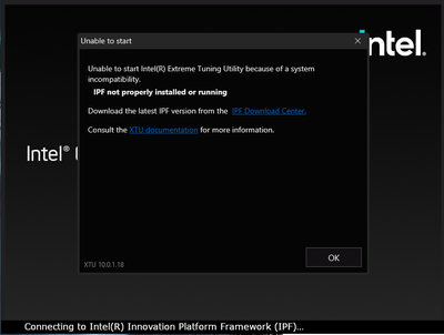

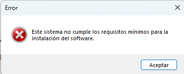

He podido instalarlo realizando los pasos de este enlace, pero al ejecutarlo, me sale ese erro.
Al instalar IPF me sale el siguiente mensaje:
¿Puede ayudarme?

Hellow intel Moderators, I have the same mistake to the others and i try to resolve doing:
1.-Execute the aplication as an Administrator2.-Desable my own antivirus and the windows antivirus too,3.-Ihave the lastes actualitation for windows 11 pro versión4.-Repair System Failures5.-Ihave the all new actualitations of Bios,Drivers,etc.
My Model of Processors is i9-13980HX (intel core),The vesrsion of Intel XTU what i dowloaded is 10.0.1.31 and my message error is this:
and whe i click up the log file the log is this:[6F6C:09CC][2025-04-12T01:47:17]i001: Burn x64 v5.0.2+aa65968c419420d32e3e1b647aea0082f5ca5b78, Windows v10.0 x64 (Build 26100: Service Pack 0), path: C:\Users\komey\Downloads\XTUSetup_10.0.1.31.exe
[6F6C:09CC][2025-04-12T01:47:17]i000: Initializing version variable 'VCRUNTIME_VER' to value '14.40.33810.0'
[6F6C:09CC][2025-04-12T01:47:17]i000: Initializing version variable 'BundleVersionNumber' to value '10.0.1.31'
[6F6C:09CC][2025-04-12T01:47:17]i009: Command Line: ''
[6F6C:09CC][2025-04-12T01:47:17]i000: Setting string variable 'WixBundleOriginalSource' to value 'C:\Users\komey\Downloads\XTUSetup_10.0.1.31.exe'

[6F6C:09CC][2025-04-12T01:47:31]e000: Error 0x80070643: Failed to configure per-machine MSI package.
[7414:69AC][2025-04-12T01:47:31]e000: Error 0x80070643: Failed to install MSI package.
[7414:69AC][2025-04-12T01:47:31]e000: Error 0x80070643: Failed to execute MSI package.
[6F6C:09CC][2025-04-12T01:47:31]i319: Applied execute package: Intel_XtuInstaller.msi, result: 0x80070643, restart: None
[6F6C:09CC][2025-04-12T01:47:31]e000: Error 0x80070643: Failed to execute MSI package.

Please help me.
