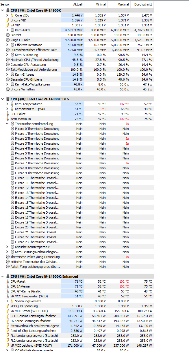

Hey Guys, I have a problem with my CPU. When I play games like DayZ, I experience thermal throttling after about 5 minutes in-game. In HWInfo, it indicates thermal throttling for about 1 second. This repeats approximately every 60 seconds.
What can I do? I know the i9 14900K generates a lot of heat, but I'm not sure if it's normal to experience thermal throttling in a game like DayZ.

Hello, thank you for your answer. I posted a screenshot from HWInfo, i played Dayz and i got thermal throttling again. This seriously makes me sad. I even switched my AIO. Now i got an NZXT Kraken ELITE 360mm AIO. And i still got these temperatures.
What can i do? is my prozessor broken? I also installed an Thermal Grizzly contact frame.
And im running the latest biops with the intel default settings.
Pls help me
