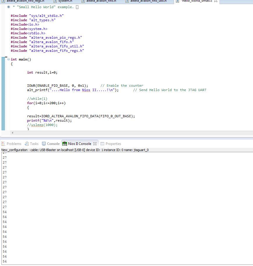

I am stuck in one design for past 10 days. Working with Altera CYCLONE V FPGA board.
I am generating Trigger Signal for 500ns and 32-bit counter (Verilog), and at every (neck edge) positive edge of Trigger signal i need to collect and store that count data into reg (final_value).
Same thing, the counter is connected to FIFO and sends repeatedly bits to fill the FIFO that is connected to Nios.
Enable signal is given From PIO., and reading the counter data from NIOS
ISSUE: IN NIOS, same data printing continously for certain number of times.
Verilog Code
module Counter( input clk, // 50Mhz input enable, input reset, output reg[31:0] Final_value, output reg trig ); reg[31:0] counter_out; reg [7:0] temp=0; reg [31:0] counter_result; wire temp1; wire temp2;   always@(posedge clk) begin if(reset) begin trig<=0; temp<=0; counter_out<=0; end else if (enable==1'b1) begin counter_out<=counter_out+1; temp<=temp+1; if(temp==25) begin temp<=0; trig<=~trig; /// Generating COunter end end end   assign temp1=trig; assign temp2=temp1&&clk; always@(posedge temp2) if(reset) counter_result<=0; else begin counter_result<=counter_result+1; // Increaming the Counter end always@(posedge trig) // Detecting Edge trig and storing into Final_value if(reset) Final_value<=0; else begin Final_value<=counter_result; end endmodule
Block Design
NIOS console
