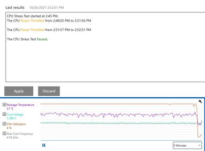

2- Run the Intel® Processor Diagnostic Tool again and share the report with us. Also, please run the Intel® Extreme Tuning Utility (Intel® XTU) and perform a CPU Stress test and share the results. If possible, share a screenshot from the Intel® XTU test.

Here is the IXTU's Results, with only the integrated
Same here, but the IPDT's results, seems to come back the same as before
 Note; all of these are with the ram's speed set to 2933MHz
And yes, turbo boost is now enabled, however as I do recall I had activated it recently when first trying to remedy my problems so I suspect it is neither a cause, nor solution to my problem sadly.
