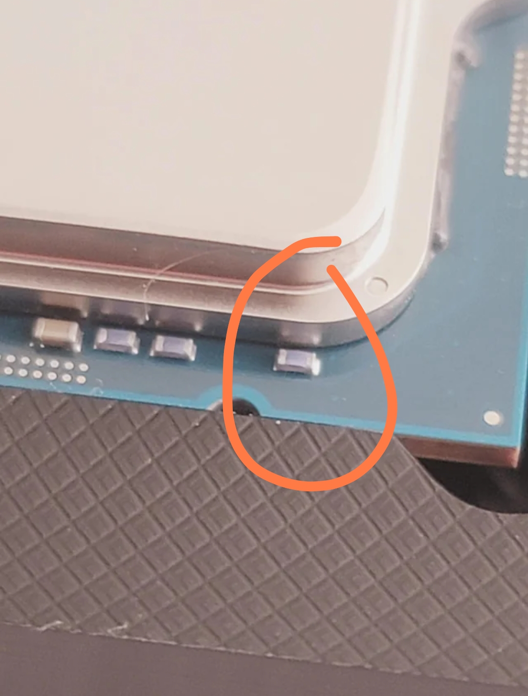

I have a question about this broken thing on the I5 13600k what is it and can be fixed?

I see the picture you provided and I'd like to know, what specific issues or symptoms are you experiencing with the i5-13600K? For example, are you encountering system crashes, boot issues, performance problems, or something else? Have there been any recent changes to your system or events that might have caused the damage? For example, did you recently perform any hardware installations, overclocking, or system upgrades
According to the image you shared, When I zoomed in, it was a bit blurry. Could you please describe what specifically is broken or damaged? For example, is there a physical crack, a bent pin, discoloration, or something else? The more details you provide, the better I can assist you

Hello i have a problem on system boot my pc won't start, in the image it's a pin i think that fell i don't know if it fell or something but i couldn't find it i found some pictures others from the same CPU with the pin attached i can provide it to help.
The photo was from Google image that i found to help

Hello again no problem for the questions i have this processor about 1 year and 3 or 4 months i really want to fix it. After i was doing some cleaning on pc after 2 days the problem appeared to not start showing problem on motherboard like CPU and then VRAM i check everything the last was the CPU processor something was missing and that was that little think, if you know what is that pin on the processor that missing that will help me i think to fix it

What is missing on the CPU is called an SMD or surface mounted device. Normally, they aren’t a problem when they fall off, maybe some stability at higher clocks.
I wouldn’t focus on this being the problem with 100% certainty.
First, what do you mean by “won’t start?” Do the fans and lights turn on, won’t go into windows, or no display output at all?
What’s your motherboard as it could have so built in testing tools that could help narrow down the options

Hello there's no image i mean the pc won't start like showing image on TV screen it's dark all working well but the CPU doesn't work because of that little pin i don't know what number of this SMD is the proper rated power that's the last missing thing i need to find for this puzzle.

The problem as i see it is on the CPU that missing SMD resistor it won't let the PC run properly it will try to boot for about 2 or 3 minutes and then it will do restart by it self and try again.
I try many ways with to start the PC no effect because of the CPU SMD resistor that missing.
The missing SMD resistor is the part that not letting start the PC properly, i need the number of it to fix it.

I also noticed that @Bcannon2000 mentioned the broken SMD component on the processor. I agree with @Bcannon2000 that SMDs might not always pose a problem when they come off, possibly affecting stability at higher clock speeds. If it's an OEM/ODM issue, you can obtain information from your FAE at Intel. This component is integral to the entire CPU, typically LGA, and for desktop CPUs, including tray CPUs, there is no option for "repair" if a CPU is defective, even if it involves replacing the missing capacitor. I understand that some "repair" shops may find this task manageable, but it carries the risk of the "repaired" CPU operating unstably due to not passing a comprehensive testing process.

Thank you for your reply. Yes, this component is essential for the entire CPU, typically LGA, and for desktop CPUs, including tray CPUs, there is no option for repair if a CPU is defective, even if the issue involves replacing a missing capacitor. Although some repair shops may try to address such issues, as I mentioned previously, there's a risk that the repaired CPU could operate unstably due to a lack of comprehensive testing.
It's crucial to use a component that matches the specifications of the broken one. Without the correct SMD code, attempting a repair with a different component may not resolve the issue or could lead to further problems. I've noted your question, and I'll need to conduct additional research on this matter. I'll get back to you as soon as I have more information.
