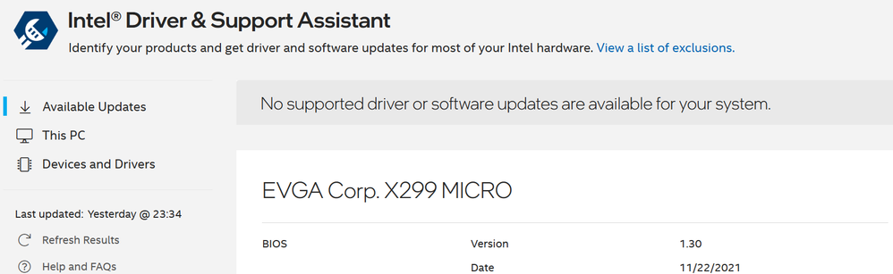

I'm experiencing persistent errors with Intel Turbo Boost Max Technology 3.0 in the Device Manager. Here are the details:
  1. I recently performed a fresh installation of Windows 11 on December 29, 2023.
  2. Despite attempting to update the driver, the error persists.
  3. The Intel Driver Support Assistant indicates that my drivers are up to date.
  4. Initially, the technology worked, but the problem emerged a few days later.
  5. My BIOS is current.
  6. Intel Turbo Boost Max Technology (ITBM) is enabled in the BIOS.
  7. The processor is overclocked using EVGA OC software, from 3.00 to 4.50.
Despite my efforts, all the information I find is outdated. I've been unable to locate turbo boost software on the Intel website, and Windows support offers generic instructions on driver updates. I have attached screenshots for reference. If anyone can provide assistance, I would greatly appreciate it as I've run out of ideas.
Actual ErrorActual ErrorDevice ListDevice List
Window ServicesWindow Services
Intel Driver AssistIntel Driver Assist
It did work at some point.It did work at some point.

After checking the SSU report we can confirm, as you mentioned, that Windows* 11 was properly installed, that the drivers and BIOS are up to date, and all the components are properly recognized.
Regarding the Intel® Turbo Boost software and drivers we would like to let you know that Intel Turbo Boost Technology 3.0 Driver & Control Panel Application (ITBM) was removed from Intel® download center due to there is an unmitigated vulnerability resulting in a PSIRT issue, so we need to have the binaries removed from download center. There are no plans to develop any new versions, so that means, the drivers and applications will disappear from our download center.
By removing the drivers and applications, you haven’t lost any CPU features of Intel Turbo Boost Max technology, the Windows Operating System has the support natively and the Intel Turbo Boost Max technology is still a feature of our processor. Windows Operating System has the support natively for ITBM. The CPU feature Intel Turbo Boost Max is enabled in hardware and pCode. There is no way to enable or disable ITBM 3.0 feature of a processor as it is enabled in hardware and pCode. You can run a tool like Intel Extreme Utility to monitor the ITBM frequency of a CPU:

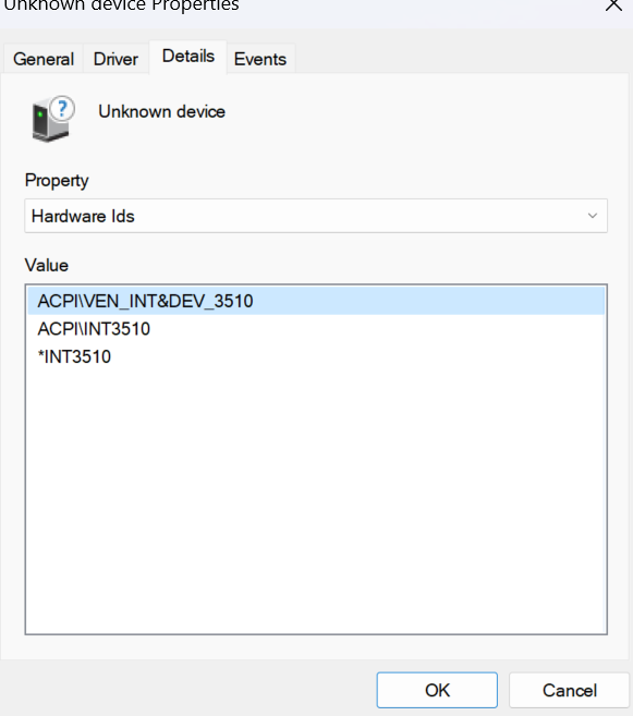

rg16
25,604 Views
I guess I'm not understanding.
I remove the driver.
I don't have the ITBM program.
The issue now becomes an unknown device under the device manager.
That's intel hardware ID correct?
So, how do I get rid of that device not having the proper drivers?
rg16
25,566 Views
I went ahead and disabled ITBM 3.0 support under the bios. That took care of the pesky unknown driver and ITBM is still running under Windows services, go figure.

Alberto_R_Intel
25,534 Views
rg16, Thank you very much for your response.
Perfect, it is great to hear that after disabling the ITBM 3.0 support under the BIOS the unknown driver was removed. Yes, the ITBM will still run under Windows services since the Windows Operating System has the support natively for the feature. Thank you also for taking the time to share the solution, we are sure it will be very useful and helpful for all the peers looking at this thread.
