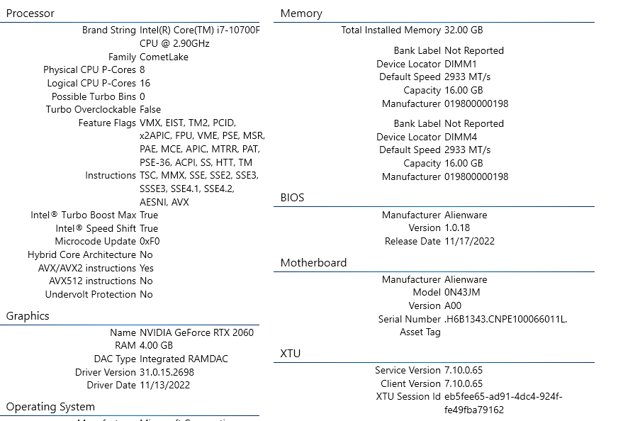

The XTU was generating huge log files. I updated to the latest version which has a GUI, and under advanced options hit "disable logging." However, it's still generating logs--just rather than a few massive files that add up to 30+GB, it's generating hundreds of 1KB files with nothing in them but: "2023/02/18-10:09:50.6961|IMP] IntelOverclockingSDK Version 6.5.1.371."
It appears to be generating one file every 10 seconds.
How do I get this to stop? System info in attached image to the extent it's relevant.

Thanks for the reply! The disable logging box is checked like in the photo, and under file logging it has a play button rather than the stop square. I did try playing around with the file logging button a bit, and it was doing the same thing with both settings. Not sure if it's a bug or what--it seems like the whole logging issue is a recurring issue that should itself be considered a bug, no reasonable computer program that mostly runs in the background should generate gigabytes and gigabytes of logs. Even linux systems delete logs by default after the period of time specified in the log manager. In any event, I've uninstalled it for now.
