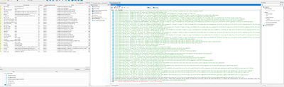

I have a Stratix V design I'm trying to migrate to Quartus Prime Standard Edition 23.1 from 18.1. During compile (in the Analysis & Synthesis section), I encountered following error message:
(12006): Node instance "altclkctrl_component" instantiates undefined entity "altclkctrl_inst". Ensure that required library paths are specified correctly, define the specified entity, or change the instantiation. If this entity represents Intel FPGA or third-party IP, generate the synthesis files for the IP.
My design doesnt call this component directly. When I clicked on the error message, it brought me to a file alt_sfl_enchanced.v which is located at the install directory: c:/intelfpga/23.1std/quartus/libraries/megafunctions/alt_sfl_enhanced.v. It look for that instance. Where is this instance suppose to reside, and how do I find it?
Easiest thing would be to either update the IP from the Project menu (do you have a yellow or red warning above the Hierarchy mentioning updating IP?) or delete and re-add the clock control block to your design.
I already updated all my IP components. There are no more yellow. See below screen shot.
On the left site, it lists all the IP I use in my project. None of them directly instantiate the clock control block. Not sure which one I should delete and re-add.

I actually manually edited alt_sfl_enhanced.v file at the install directory to comment out the few lines for the alclktrl_component. After that, compile was successful. But obviously we are not sure the repercussions of doing this editing since it's to be part of Intel IP. Please email me. we are working on a strip down version of the design to share with you.

I just wanted to inform you that I'm working closely with the engineering team to evaluate this issue and assess any associated risks.
The engineering team does not recommend reverting the SFL logic, as doing so may lead to unnecessary pulses or glitches, as mentioned in the following KDB article: https://www.intel.com/content/www/us/en/support/programmable/articles/000088178.html.
Users will need to add the altclkctrl module to their design.
Or
Recommend those who are using SFL IP to upgrade from older versions.
