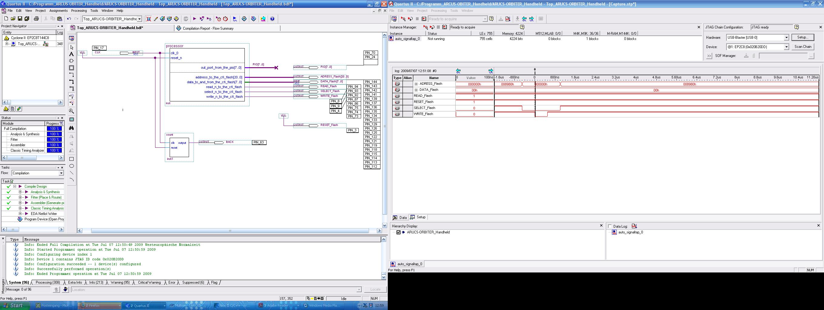

Yes, I think so. I have a AT49BV163DT connected. The times for settling etc. in the sopc builder gui are set to 100 ns. I think a longer time than needed shouldn't be a problem. Suspicious is the one time write access to the flash ram. (PIC_Signal) There should be more than one write access, shouldn't it???
You should have a special write (data 98h to address 55h) to enter CFI mode. It may come a lot later in your curve. Can you increase the buffer size and reduce the sampling clock frequency?
Or a better way could be to divide the buffer in several zones, each one of them triggered on an access.- Mark as New
