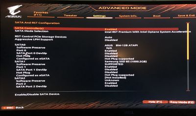

I have a Win 10 PC with Gigabyte Aorus Elite Z590 MB, NvME SSD Main Disk with O/S , SATA SSD storage and a HDD Raid 0 Config for storage.
The PC completed some Windows Updates in the last few days and subsequently I get this error message on startup/POST and it will not boot to Windows afterwards, I'm assuming the Windows updates may have generated the conflict, though one of the Raid 0 HDD's seems to be no longer detected in the RAID, so it may have failed or some conflict developed and that's the cause, though I don't know why that would prevent the machine from booting as the RAID isn't the boot drive, BIOS screenshots attached.
Suggestions on a fix that doesn't involve wiping all my drives are welcome. I can get to the BIOS and see and change the config if necessary. The RAID is regularly backed up so breaking it is an option.

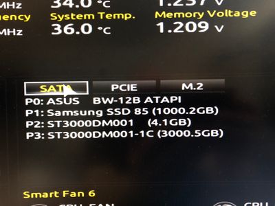

Fair observation - but all the drives are detected in the BIOS, see attached, I believe one of the Raid Discs may have failed, (though the drives are still detected in BIOS) but I do regular backups so I'm not too concerned about that, I have a feeling once the issue with IRST is resolved the drives will come back online
Trying to figure out how to reinstall IRST without nuking the boot disc is probably all I need to do to move forward - I think the storage disc will come back online once the issue is resolved, I used clonezilla to clone both the NVME boot drive as well as the SSD storage last week using a boot disc without any issue

Hello BB12388, I just received an update on this matter.

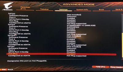

As per IMG_3202 there is 1 HDD with issues:
SATA1: Samsung SSD 980 1TB >> Status OK
SATA2: Seagate Desktop HDD 3TB >> Capacity just 4.1 GB out of 3000.5 GB, so there is something wrong with this drive
SATA3: Seagate Desktop HDD 3TB >> Status OK
Also, as per IMG_3054 and IMG_3056, this drive is not being properly detected showing the status for SATA2 as Not Installed,
Additionally, in the link below you will find the User Guide with the details you requested, page 41 for deleting the RAID Volume and page 116 for the Uninstallation but we just wanted to be clear that the issue is not related to Intel® RST, is a faulty drive:

Alberto_R_Intel
12,090 Views
BB12388, I just received another update on this matter.
In this case, if you do not have the UI (User Interface), that means the RAID was created by using the BIOS setting. For that scenario, the next thing to do will be to get in contact directly with Gigabyte Support so they can further assist you in removing the RAID since they support everything related to the BIOS:
https://www.gigabyte.com/Support
