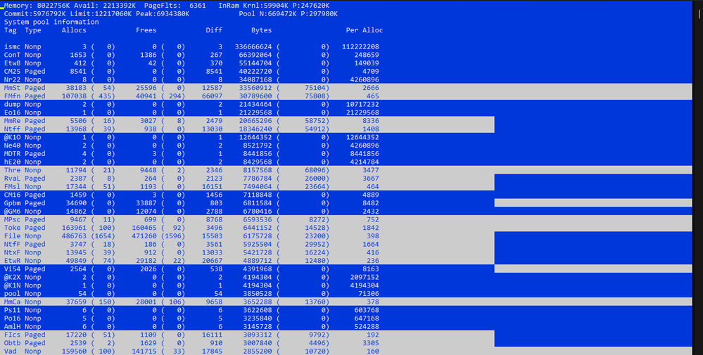

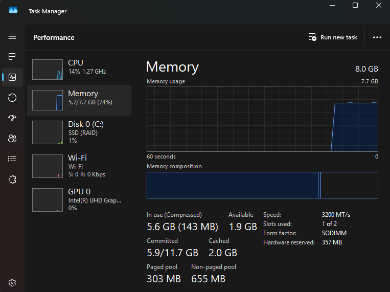

Non Paged pool unusually high (ismc non-paged pool)

Thank you for reporting this issue and providing the diagnostic images. Based on the system data you shared, we have confirmed that your system is experiencing a memory leak within the Intel Storage Management Component (ISMC) that requires immediate attention.
Technical Issue Analysis
The data from your Task Manager and pool analysis clearly identifies the source of the problem. Specifically, the ismc pool tag shows:
ismc Nonp: 3 ( 0) 0 ( 0) 3 33666624 ( 0) 112222208
  • 3 allocations, 0 frees: This indicates 100% memory retention. The driver is claiming memory but failing to release it back to the system.
  • 33,666,624 bytes allocated: This volume of memory is being held with zero cleanup.
  • Pool tag "ismc": This identifies the Intel Storage Management Component, the core driver for Intel RST and RAID operations.
This behavior leads to a progressive memory leak, resulting in the 96% memory utilization and elevated Non-Paged Pool levels shown in your reports. Because Non-Paged memory cannot be swapped to disk, this leak will eventually cause significant system instability.

  • Your diagnostics show 1 of 2 SODIMM slots is occupied. Given the current memory pressure, we recommend considering a memory upgrade (moving from 8GB to 16GB) to better support RAID operations.
  • 3200 MT/s memory was detected; please ensure your BIOS is set to optimal performance settings to utilize this speed fully.
