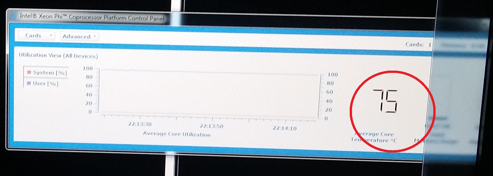

There are some kind of instabilities with my Xeon Phi 31s1p. With or WITHOUT(!) a job on the coprocessor there are events like
june 16 2015 21:02:31: Warning: mic0: Device connection lost!
june 16 2015 21:03:47: Information: mic0: Device connection restored
With an OpenCL job the situation gets worse: it may loose connection or raise blue screen of death :) IRQL_LESS_OR_EQUAL in some MPSS dll (I will take a screenshot later).
In case of BSOD micras log contains nothing. I will try to reproduce connection issue and attach micras log.
There is no overheating. In idle mode Phi has 63C, with a job - 75C.
Nothing changes with downgrade (or upgrate) between MPSS 3.3.4 and 3.5. OpenCL runtime is 14.2.
I afraid it's hardware issue with the coprocessor...
Any ideas? How to investigate? May be it's local overheating? micctrl -t gets me safe values.
Thanks!
I have upgraded my hand-made active cooling system with a vacuum cleaner. Vacuum cleaner through flexible adapter is able to create a very powerful airflow. :) As a result temperatures have dropped to 47/55 C.
Same ploblem exists. So it's not an overheating.
I have no ideas what to do next... :\
