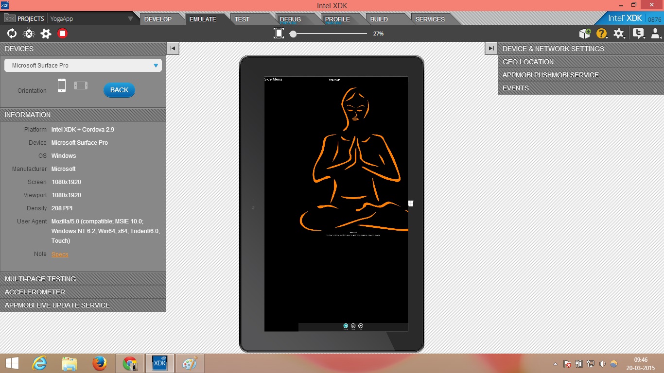

I have created the Yoga App using App Starter and Version of Intel XDK is 1.0.9.38.
The Problem is now described with images also :
1)I see the images very nicely When I emulate the app.
2)But it does show the images in the App Preview.
I First emulate it on microsoft surface pro which is windows 0S and then I ran it on my phone which also run Windows OS.
Now,I have attached the images for further clarification................................................................

My experience is that WP8 does not seem to handle SVG in the App Preview. Can't say if built apps are different.
Anusha_M_Intel1
8,630 Views
I was going to say try a different image file format but Barrett beat me to it :) You could try just any .jpg or .png image and see how it renders.

I Just try to render the images of other format it worked correctly.
But I have one more problem that now as the images are being displayed but they do not scale according to my phone.
1)I have attached the picture for that you can see that there is large gap between the scrolling button and images and its content.Please help me with this
2)After I Choose the app I want to view, and when I am done and push the back button of my Phone Phone,the Intel App Preview crashes and I directly reach the home of my phone.
