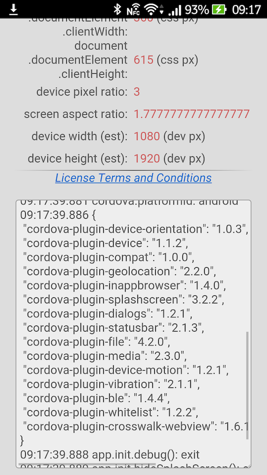

Abdul -- make a new project based on the "hello cordova" sample app and add those two plugins to the app and build an APK. Then run that APK on your two devices. Scroll to the bottom of the app's screen and scroll within the "text area" below the "license terms and conditions" link. Then scroll within that text box until you find a list of plugins that are part of the app, similar to what you see in the screenshot below. If you see the plugins you added to this sample they will show up in the list (they are not part of the list I'm showing below because this is a build of the standard sample).

Abdul -- perhaps you are using the wrong technique or an older version of the XDK? This plugin requires Cordova CLI > 6.0, which means you'll have to use 3491 or later to install it into your project (because 3400 and older uses Cordova CLI 5.x to "install" the plugins into your project). Likewise, you need to insure you're building with CLI 6.2.0 in the Build Settings. I just did the test I outlined in a previous post and I can see that the plugin is present in my app. Likewise, and "evothings" object shows up in my JavaScript namespace, which I believe is where this plugin's API is accessed (at least according to the example). I see the README says you should add some JS lib files to access this at a higher level, I haven't tried that, but I'm pretty confident that will work, as well. BTW -- you do not add those JS lib files as plugins, those are just simple JavaScript library files that you add using a <script> tag in your index.hmtl file. I recommend you add them AFTER the cordova.js script tag, not before. See the comments at the bottom of the "hello cordova" index.html file for the recommended order of JS scripts in your app. Those add-on BLE JS libs are "device-dependent" JS libraries, not "device-independent" JS libraries.
Some pictures might help:
In the Simulate tab:
from the Simulate debug console:
From a built app on a real device:
