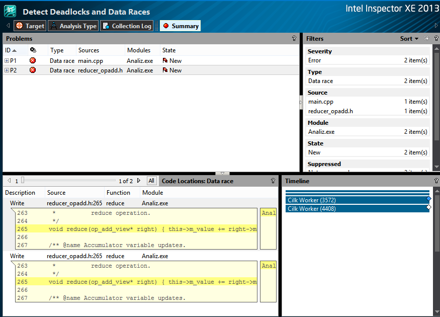

P1 and P2 data race problems  are appear when I inspect program . I haven`t got experience about Cilk Plus. I guess error is occur in nested loop . What should I do ?
    char * primary;
    char * secondary;
    primary = ( char * ) malloc (size * 15);
    secondary = ( char * ) malloc (size);
    cilk::reducer_opadd<long>number (0);
    cilk_for (int i= 0; i < size ; ++i)
        cilk_for (int j = 14;  j >= 0;  --j )
            number += (primary [(14 -  j ) + ( i * 15)] * (pow (3 ,  j )));
        if (secondary [number.get_value ()] == 0)
            secondary [number.get_value ()] = 1;
        number.set_value (0);

A cilk_for loop runs all iterations of the loop in parallel. You have no need of "number" outside of the cilk_for loop, so why bother with the reducer? Instead write:
        long number = 0;
        if (secondary [number] == 0)
            secondary [number] = 1;,
            count++;
Now each iteration of your loop has a private copy of "number." Of course, you've still got a race on "count". That may want to be an op_add reducer.

Well, to start with, the value of a reducer in the middle of a parallel region is undefined, since the computation hasn't completed yet. I *think* what you want is to move the declaration of your reducer inside the outer cilk_for.
Of course, then there's the question of why you need the inner cilk_for at all. It's not all that much work. Then you can just move the declaration of "number" inside the cilk_for, and each of the cilk_for iterations will have their own copy.
    - Barry

I understood inner cilk_for is unnecessary . I have changed following way but data races are continuing.
exactly why the error is due ? Can show me over my code...
 cilk::reducer_opadd<long>count (0);
            secondary [number.get_value ()] = 1;,
            count++;

I get it now. Data race problems were solved. Thank you very much :) Do you have resources that you recommend for learning parallel programming ? Where should I start ...
