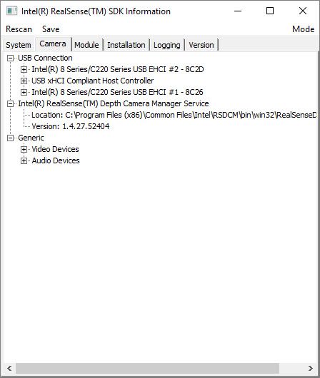

Unfortunately, the output from my sdk_info tool looks somewhat different.
Could this mean that Windows 10 did not upgrade the firmware?  I am unable to install the Intel Driver because Windwos 10 1511 included a newer version of the driver.
