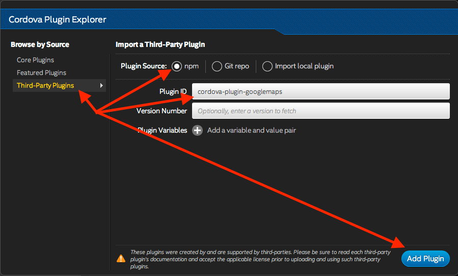

Note the author says you should not use the git repo > https://github.com/mapsplugin/cordova-plugin-googlemaps#quick-install < because it may not be stable or complete, which is true of any plugin. The "master branch" of a git repo is not guaranteed to be a stable release. Use the NPM repo to add the plugin, as shown below:

Which means that you must use our CLI 6.2.0 build system to build for Android. And, according to this note > https://github.com/mapsplugin/cordova-plugin-googlemaps#information < you must use our Cordova CLI 5.1.1 build system for iOS, until they release their 1.4 version of the plugin.
I did an Android build (which is what happens when you use the Debug tab) and it built successfully. I did not try an iOS build. I used the NPM release (1.3.9) not the github master branch, although the info note > https://github.com/mapsplugin/cordova-plugin-googlemaps#information < says you can use the master branch but there are still bugs. So if you do use the master branch of their github repo you could use just our CLI 6.2.0 build system for both Android and iOS builds. I would recommend NOT using the iOS WKWebView, because that is probably where the bugs are.
