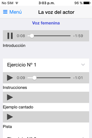

I'm using the audio tag to play mp3, and works fine except on IOs, as a mobile app or web app. The code is:
<audio controls="controls" preload="none">
<source src="audio/intro.mp3" type="audio/mpeg">
</audio>
The control is displayed fine and the audio is correctly played. But its not possible to restart it and the slider doesn't work either. Only play and pause.
Is the same in app compiled as mobile, or a web app opened with Safari mobile.
Android mobile app, or opening the web app with a browser has all the features. Restart and move the slider to go fwd or back. The web app on OSX Safari works as expected.
Is this a limitation? If it is, anybody knows a workaround?

I've tested in IOs 9.2 as an adhoc installed app on Iphone 4S, and on Iphone 5 IOs 9.2.1 with App Preview. The same on both situations, I can't use the slider to move the audio track position:
Here is a screenshot:
As a webapp is the same

My audios are played on IOs, I can hear the sound, the problem is that the audio tag doesn`t respond to interaction, like move the slider.
My app is about voice excercises, the user may need to go back or forward, or reset the track
