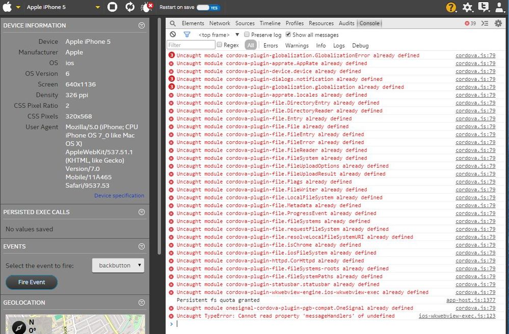

When testing in simulator I get a blackscreen and this from the console
What am I doing wrong ?

The Simulate tab does not work well with third-party plugins. It does not include the backend parts needed by your OneSignal plugin, so some things will not work. Best to debug your app first in a built Android app, then move to iOS. See these instructions re how to debug a built Android app > https://software.intel.com/en-us/xdk/docs/intel-xdk-debug-and-test-overview#RemoteChromeDevTools <
