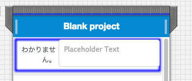

I live in Japan and use a Mac with the OSX version of the XDK in English and an American keyboard with Kotoeri enabled so I can select the keyboard input method as hiragana. I had not actually tried the XDK with this until yesterday. It works just fine in 1816. Just remember to switch it to the appropriate input method for the location where you are typing or interesting stuff may happen.
Here's a sequence of screenshots attached.

Hi, John and David,
Thank you for the comments.
I'm using XDK on Windows Server 2008 R2.
Unfortunately, the problem still exists on the version 1826.
But when I tried 1826 on another PC (Windows 8.1), it shows Japanese characters successfully (using same project files)!!
It seems the problem is caused by some mismatch between OS settings and recent XDK.
I will change my development base from the server to my PC.
tetsuya
