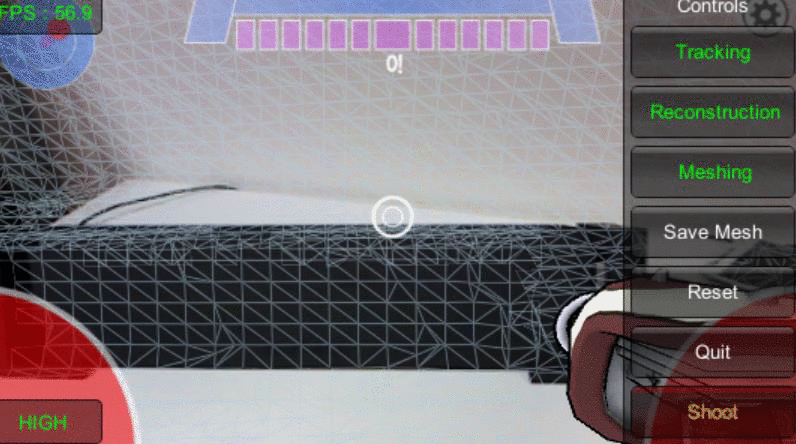

Hi RealSense devs!
I was wondering if there was a way to increase the scale of the mesh in Unity.
I copied over the files from the RealSense demo into my project.
I was able to scale up the mesh by modifying the scale of the prefabs that are spawned in DepthFusion.cs
//DepthFusion.cs
GameObject gameObjInstance=(GameObject)Instantiate(m_meshPrefab, new Vector3(0, 0, 0), Quaternion.identity);
					gameObjInstance.transform.parent = m_meshParent.transform;
					gameObjInstance.GetComponent<DynamicMesh>().SetData(meshId, m_meshes[meshId].Key, m_meshes[meshId].Value);
//Code added to increase the scale of the instantiated mesh.
gameObjInstance.transform.localScale = gameObjInstance.transform.localScale * 10;
But I think I'm not able to get the FOV right, and I see a drift during the tracking because of that.
I was wondering if there was a better way of increasing the scale, or an easier way of finding the FOV than trial and error, that is, if the FOV is the issue.
Below is a GIF of the scaled mesh drifting, unscaled meshes work perfectly fine (when the camera is left at the default FOV of 49.04.
Thanks for your time!
- Ashwin
