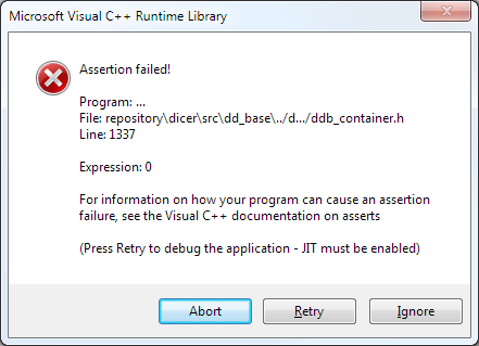

I get an assertion while running the Intel Parallel Amplifier. After I press Ignore repeatedly, I am able to get the product to do what I want (which is to start with data collection paused), but it doesn't feel right to have to do that.

Please, provide the Amplifier update/build number.
What was the analysis stage when you got the assertion?

I have such error every time I start Amplifier. I've sent several reports to [email protected] but there're no answer. Here is one of dumps:
[Exception]
Address: 0x71E68848
Code: 0x80000003
Description: EXCEPTION_BREAKPOINT
Module: MSVCR80.dll
[Dump]
C: Usersjia3epAppDataLocalTempampl-log-jia3ep2010-03-05-Fri-17-28-16-657crash.dmp
Path: C:Usersjia3epAppDataLocalTempampl-log-jia3ep2010-03-05-Fri-17-28-16-657crash.dmp
[Product]
Package ID: N/A
Package Contents: Intel Parallel Amplifier Update 2
Build Number: 76442

jia3ep
2,847 Views
Assertion screenshot:
Kevin_Magee__Intel_
2,847 Views
I am working with jia3ep via private communication to investigate these crashes.
jia3ep
2,847 Views
The problem persists at this moment. I've sent all additional information that lets reproduce this problem 9 days ago.
Kevin_Magee__Intel_
2,847 Views
jia3ep,
Intel Parallel Amplifier Update 3 is now available to download from the registration center.
This latest update should resolve the unfortunate crashes you experienced. Thank you for submitting the crash reports so we could work on them. We encourage all customers to install update 3.
