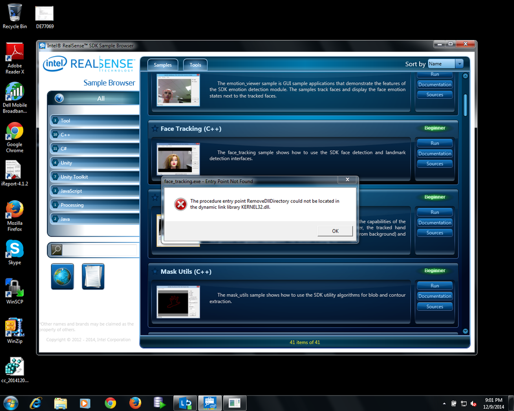

I am getting below mentioned error.
I have tried mutiple times to reinstall and install RealSense SDK but when i try to run the sample program from sample browser i do it i am getting below error.it will be highly appreciated if someone can help me in this,

RealSense SDK need windows 8.1. You can find detail info @https://software.intel.com/sites/landingpage/realsense/camera-sdk/2014gold/documentation/html/index.html?devguide_hardware_and_software_requirements.html
