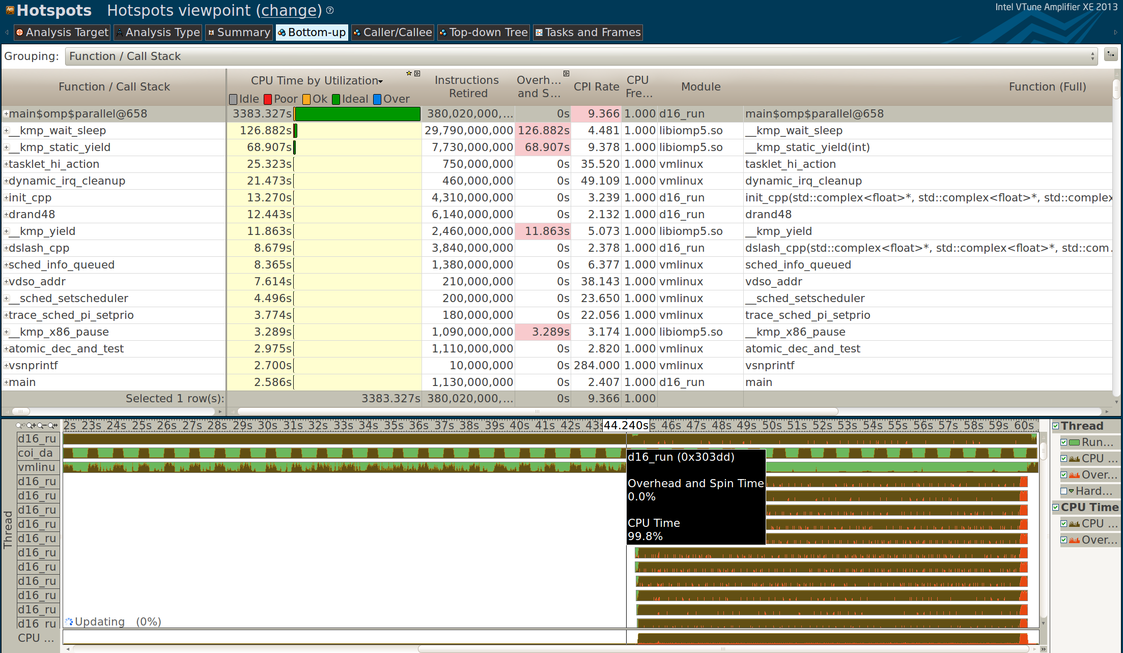

In looking at your VTune screenshot there is no work being done in other than one p16_run... thread until about 46 seconds. The other p16_run... threads do nothing until ~46 seconds into the run, then run for negligible amount of time.
I suggest you create your threads, have kernel set affinity if you wish, then issue a condition variable wait. When your create thread loop is finished, then signal all the condition variables. This will remove the thread creation time from your timing section. Thread creation may have significant overhead.
Also, in your last code post you were using a &thread_attr... If this thread_attr is specifying a higher runtime priority than the main thread's priority creating the additional threads may be problematic should a newly created thread be assigned to the same logical processor as the main thread (IOW this would serialize the program, different threads, but running one at a time.)
Evgueni's comment is valid when the main thread participates in the work (e.g. calls kernel as thread with your ID of 0 or last thread). However, as coded, the main thread is not performing work (calling kernel).
I notice that threads vmlinux and coi_daemon are eating up a considerable amount of time. I would venture to guess that these are related to running VTune. If this is the case, then you might consider diminishing the total thread count during VTune runs (e.g. use 236 an stay off the last core).
Jim Dempsey

Thanks for that nice hint. You are totally right. Now the vtune analysis of my other OpenMP code looks quiet perfect (compare omp.png).
I have a big scalar part at the beginning of my program (just for checking my intrinsics kernel), which you can also see in the OpenMP vtune analysis (omp.png) and in my Pthreads code.
