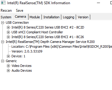

from the camera tab of sdk info there is a device 1 tab [without camera running] if you select it a firmware number is listed
i think this is the camera firmware.  what should that number be.
christopher_b_3
4,359 Views
Hmm, still don't see what you are referring to. Here's what I see:
DKryd
4,359 Views
does not surprise me that it does not show for you. this software is such a mish mash.  can not communicate if we both do not see the same thing
