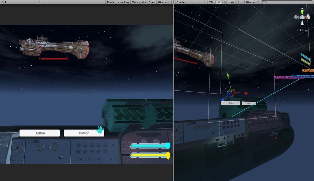

Initial position:

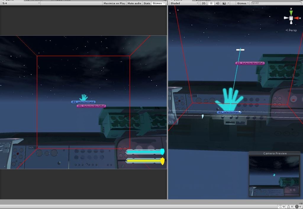

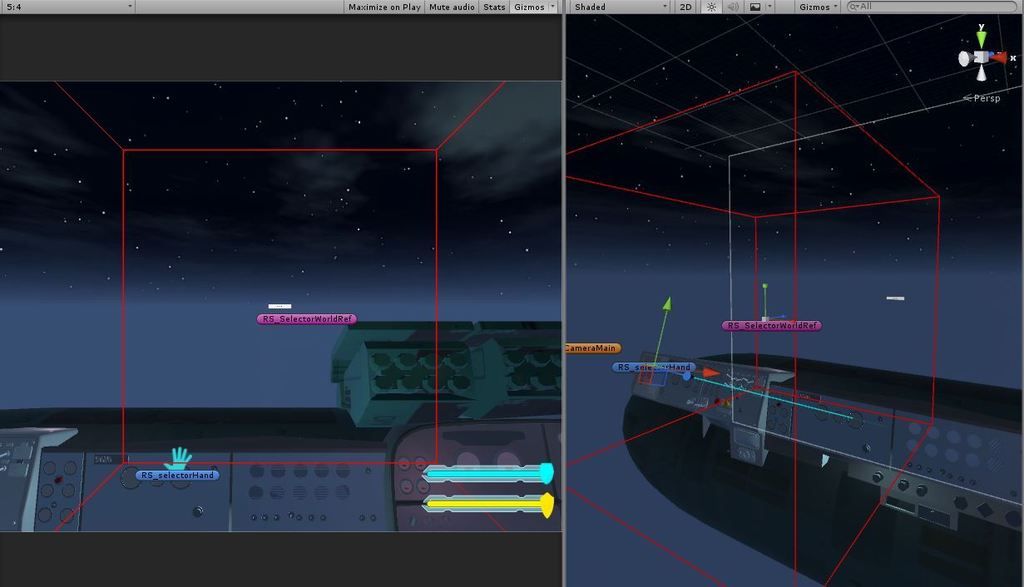

Lines up perfectly with the centered button UI in worldspace...Moving the hand around, target apparently locked at initial position:

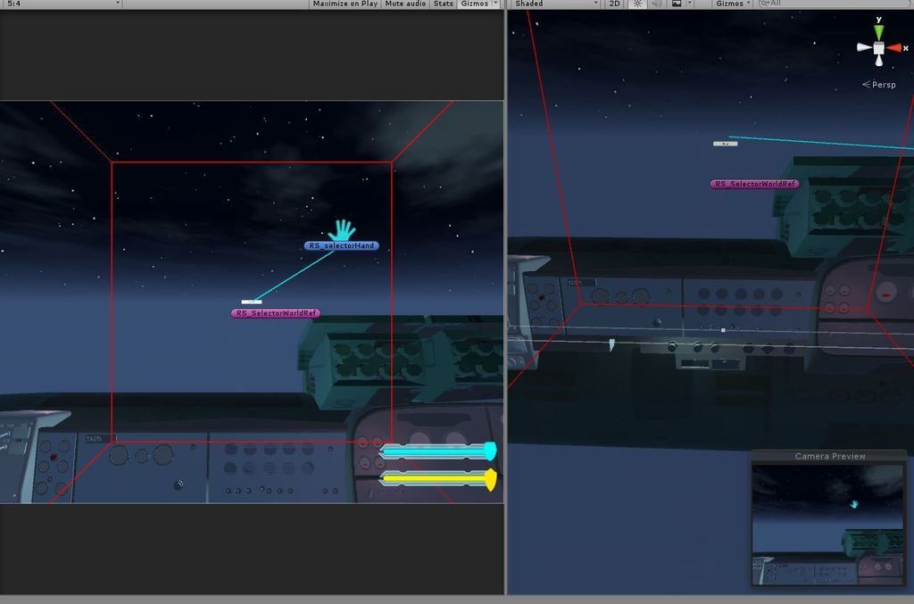

Still targeting the center of the screen, even though I want to point the ray forward...
I'm using the RSUnityToolkit Tracking Action to move the mouse-pointer-esque, hand-tracked sprite.  When I run this visual debug gizmo in play mode, the raycast initializes perfectly in line with the camera and the local origin, but that's because my hand tracking sprite icon starts there.  Moving the hand tracking icon around, it's clear that the point remains locked in the distance at that point.  This is not what I want.  I want the raycast to match the perspective of the camera.  If the user hovers the tracked sprite's pivot directly over an object on screen that may be selected with a gesture (or whatever), the user should be able to interact with that object.
That's all I want to do!  Target an object with Hand Tracking.  Maybe it's the way my object is set up in the scene?  Maybe it's the way the Tracking Action references the central position?  Do I really have to dig into the Tracking Action rule to figure this out, or is my idea of forward relative to the camera just incorrect?

Problem solved.
I wanted my hand sprite to "look" in the same direction as the camera, which requires the hand sprite to rotate a little bit... so it can look in the required direction.  Basically instead of wanting the hand sprite to "LookAt" the camera, I want the opposite of LookAt, which can be done using LookRotation.  I'm using the Camera's forward direction, which should be the same as Vector3.forward
	void Update () {
		transform.rotation = Quaternion.LookRotation(transform.position - Camera.main.transform.position);
	void OnDrawGizmos() {
		Vector3 fwd = transform.TransformDirection(Vector3.forward);
		Gizmos.color = Color.cyan;
		Gizmos.DrawRay(transform.position, fwd * 500);
Precisely aiming the raycast directly through the sprite's pivot and into the world!
Pointing into the world space using a hand that moves around in the space not only on X and Y, but also in and out on Z.  Pretty cool.
