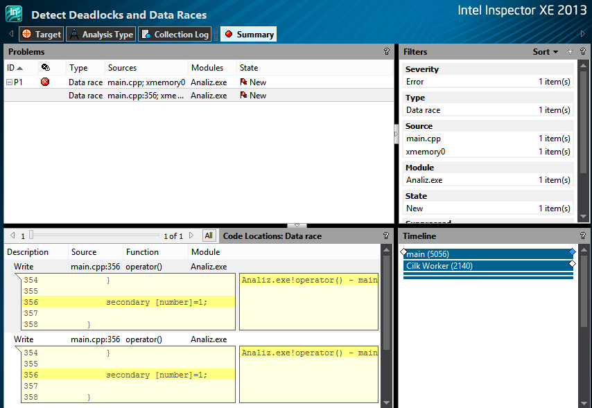

Here part of code ...
vector<char> primary (14348907*15);
vector<char> secondary (14348907);
cilk_for (int i= 0; i< 14348907; ++i)
int value= 0;
for (int j= 14; j>= 0; j--)
value+= (primary[(14 - j) + (i* 15)] * (pow (3 , j)));
secondary [value] = 1;
And test result....
Now I want to learn should I use lock otherwise should I use another container like reducer_list or reducer_vector. Which way is better for performance ?
It is true that there are data races coming from the writes to "secondary", but you can ignore it in your code since the race does not affect the semantics of your code; the contents of "secondary" do not depend on the ordering of the write operations since they are loop-invariant (constant).
While Hansang is correct that you code will give the correct answer, you may still suffer performance problems due to cache effects.
