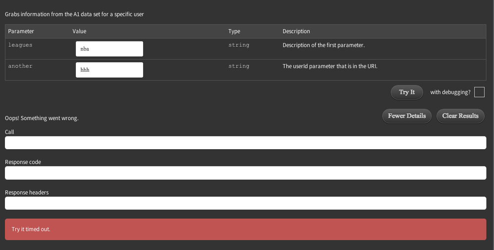

I'm new to xdk, and I'm trying to create a new web service to talk to our website (RESTful) , however I can't get it to work. I followed the example in this video
https://software.intel.com/en-us/videos/integrating-a-new-service ;
but no luck. When I try the service it basically returns with a timeout. ( Before anyone tells me that http://api.espn.com/v1/now is no longer working I know, but I tried different ones including my site , the response from the API Explorer Sandbox works fine.
The problem I see is that call is empty which leads me to think something is not being passed through.
Intel XDK version 3759

Have you also reviewed this doc page? > https://software.intel.com/en-us/xdk/docs/using-web-services < especially the section titled "Integrating Your Own Services"?
Hi Paul,
Yes I have a few times, its pretty much the same instructions as the video. I have also looked around in forums and found we must include in the compatibleProjectTypes apiconfig.json file otherwise it doesn't show up in the list.
Have I missed something?
There is a bug that was recently uncovered, you might be succumbing to the same. I don't have the details, so I can't say for sure. This is the thread > https://software.intel.com/en-us/forums/intel-xdk/topic/703233 <
Thanks Paul, this matches the same symptoms I'm experiencing. I will follow it ..
Is there a way to download an older version of XDK?
Appreciate the help
I downloaded version 3522 to get it working for now...
Tested with my existing project it didn't work as well.. so started from scratch and its working, will use it until 3759 is fixed.
This is the same as the issue in topic https://software.intel.com/en-us/forums/intel-xdk/topic/703233
You can find the previous download links to the previous version (3641) in this thread > https://software.intel.com/en-us/forums/intel-xdk/topic/705276 <
