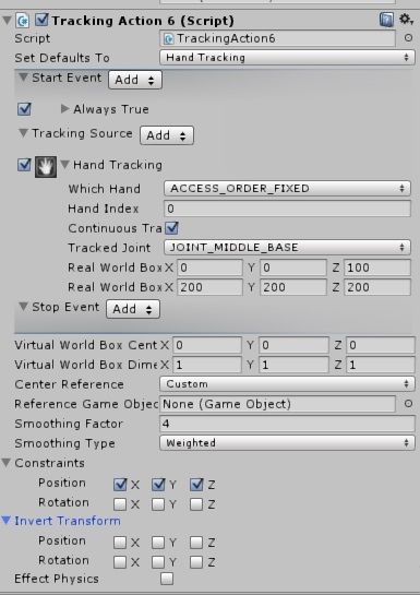

MartyG
3,596 Views
I found a neat solution that enables wrist turning to be detected with only a small wrist turn to the left or right, stopping the object before it can mis-travel far.
STEP ONE
Create an object that has all Position constraints locked and all of the Rotation axes unlocked.  Here is an image of my avatar's shoulder TrackingAction.
STEP TWO
Run your project and, whilst holding your hand in front of the camera and turning your wrist fully left and fully right, observe how the rotation values in the Inspector panel of Unity are changing in real-time.
Work out which one of the three directional axes (X, Y or Z) changes the least in the plus and minus degree directions (what we we could a small travel range would be something like -350 and 10 (10 degrees either side of the object's 0 degrees start position).  The axis that changes the least should be the one that you set the angle detection script from earlier in this article to check.
The reason for this is that you want to be able to move your object around freely with the normal up-down-left-right hand controls without accidentally freezing the object's motion.  You only want the freeze to take place when you turn the wrists.  If you use the axes that change by the greatest amount to detect the angles, this means that you have to set a wide range of degrees that the hand can move freely in before the freeze triggers, otherwise you will be setting off the freeze accidentally almost constantly.
A consequence of this though is that the wrist has to turn at least half to three-quarter way around before the freeze initiates though, meaning that your object has already mis-traveled quite a distance.  So it makes the counter-wrist mechanism almost pointless for the purposes of stopping mis-rotation.
However, if you identify the axis that changes the least during left-right wrist rotation then this means that it will be particularly suited to be your angle detection axis.  This is because wrist-turn driven objects usually travel further and faster than when the normal hand controls are being used.  Therefore, you can set a short range for the detection trigger (e.g -10 or +10 degrees), and the object will not travel far enough during normal (slower) up-down-left-right hand control to reach those trigger angles and set off the freeze at the wrong time.
In my own project, I found that of my three open rotation axes, Z traveled the least distance when the wrist was being rotated.  So I changed my script to set Z as the axis to run the degree value checks on.
public void OnGUI()
	rotationanglez1_rightshoulder = transform.eulerAngles.z;
if (rotationanglez1_rightshoulder > 35 && rotationanglez1_rightshoulder < 340) {
			RestartMotion ();
			GameObject.Find("Lower Right Arm Movement Pivot 2").GetComponent<TrackingAction7>().RestartMotion();
			GameObject.Find("Lannel Right Hand - Bend Up-Down").GetComponent<TrackingAction7>().RestartMotion();
			GameObject.Find("Right Middle Base Rotational Joint").GetComponent<TrackingAction7>().RestartMotion();
			GameObject.Find("Right Middle 1 Rotational Joint").GetComponent<TrackingAction7>().RestartMotion();
			GameObject.Find("Right Middle Finger Fingertip Rotational Joint").GetComponent<TrackingAction7>().RestartMotion();
			GameObject.Find("Right Index Base Rotational Joint").GetComponent<TrackingAction7>().RestartMotion();
			GameObject.Find("Right Index 1 Rotational Joint").GetComponent<TrackingAction7>().RestartMotion();
			GameObject.Find("Right Index Finger Fingertip Rotational Joint").GetComponent<TrackingAction7>().RestartMotion();
			GameObject.Find("Right Ring Base Rotational Joint").GetComponent<TrackingAction7>().RestartMotion();
			GameObject.Find("Right Ring 1 Rotational Joint").GetComponent<TrackingAction7>().RestartMotion();
			GameObject.Find("Right Ring Finger Fingertip Rotational Joint").GetComponent<TrackingAction7>().RestartMotion();
			GameObject.Find("Right Thumb Base Rotational Joint").GetComponent<TrackingAction7>().RestartMotion();
			GameObject.Find("Right Thumb Middle Rotational Joint").GetComponent<TrackingAction7>().RestartMotion();
public void RestartMotion()
		SmoothingType = SmoothingUtility.SmoothingTypes.Stabilizer;
	StartCoroutine (PauseTracking ());
IEnumerator PauseTracking() {
	yield return new WaitForSeconds (1);
	SmoothingType = SmoothingUtility.SmoothingTypes.Weighted;
Now when I ran my avatar project, it only took a small left or right wrist turn to activate the freeze, yet the freeze never occurred during use of normal hand controls.  Because I had set up a freeze activation list in the arms but not included the TrackingAction in the wrist in this list, I was now able to use left-right wrist turns to rotate the avatar's hands without the rest of the arm rotating with it.  I had finally succeeded in conquering wrist rotation!

Select one the TrackingAction-enabled rotation joints so that you can view its Trackingaction settings - in particular, the 'Weighted' setting - in the Inspector panel.  Then run the project and move your hand up and down.  When moving the hand slightly in the up or down direction, the status of the Weighted option should change almost immediately to 'Stabilizer', signifying that the object's rotation has been frozen and can no longer mis-rotate as you move the hand.
When you stop moving your hand, you should observe that the Weighted setting automatically returns to the 'Weighted' status, signifying that the joints are unlocked and can be moved.

Edit 3: I found the solution to the problem with switching from 'Weighted' to 'Stabilizer'.  It was in the smoothing value.  Stabilizer didn't like it if the smoothing value was greater than 1 and was forcing the position of the objects' axes to reset to zero, burying them inside the avatar's head.  Using a Stabilizer value of 1 prevented the objects from disappearing.  They were now moving a little faster than I would have liked (the typical weighting value of face parts in my avatar was 4 or 5) but it was a relief to at least have the freezing mechanism working great for the face now.
Edit 4: I worked out a simple solution to the problem of Stabilizer only being able to use smoothing values of less than 2, making facial part movement too fast.  Above the statements that change the Smoothing type, I added a line that alters the smoothing value suited to a particular Smoothing type before making the change.  So with the freezing instruction, I set smoothing to '1' before switching to Stabilizer.  And when changing back to the Weighting type, I changed the smoothing value from '1' back to '4' before making the mode change.
		SmoothingFactor = 1;
		SmoothingFactor = 4;
	public void RestartMotion_Cancel()
