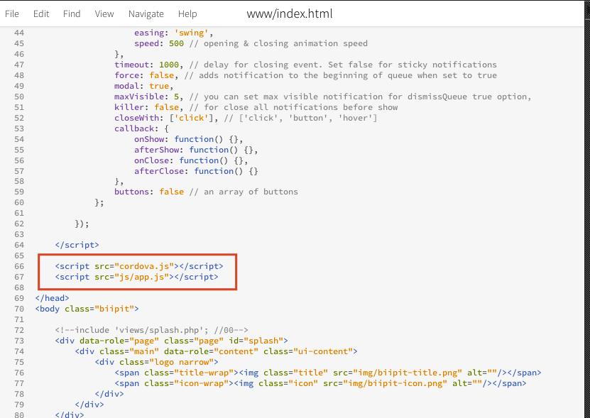

Can you post complete html code, not just JS?

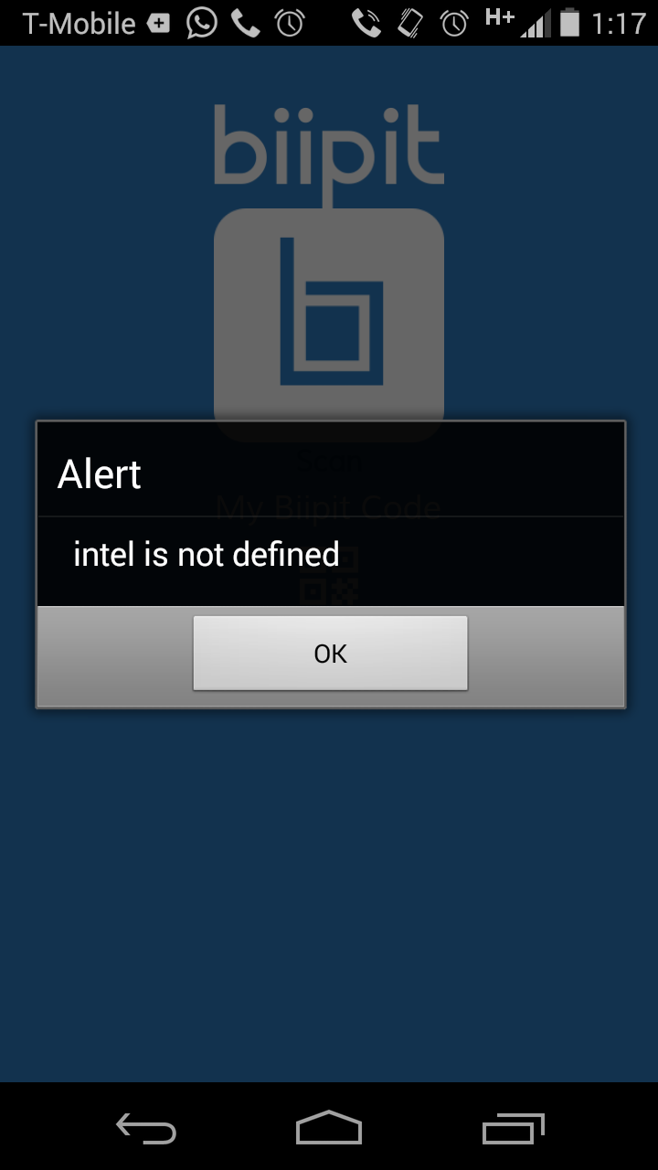

I understand that, no I can not build an IOS app, but I build an Android App, and when I click on Scan I get intel is not defined, see screen shot

check the "device" plugin for intelxdk, it will work, your code worked for me in android build
also u dont need intelxdk.js script tag, remove it, u just need to have cordova.js script tag,
I am confused you create Android build or Cordova Android build, by the way I have the plugging device checked on Intel XDK session, is that correct?
I created Cordova android build
Ok but the scan works or said Intel is not defined
Thank you
scan works, i just took your index.html attached by you, changed intelxdk.js to cordova.js, checked "device" under intelxdk plugins, built cordova android build

Bro I am sorry to bother you but see screen shoots please, really I am very upset with this situation and now can not test my app on IOS device because said that can not download the app from the cloud, please let me know if you can connect to my computer to help me, thank you.
Come on man is impossible I do the same steps that you said and always get intel is not defined... see the latest screen shots..

Yes I was playing with but always get cordova require is not a function, but I am sure that the problem is with Intel XDK for OSX that do not include the Intelxdk.js and device pluging even checked on project settings and they don't fix this problem at the moment.
