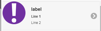

jQuery Mobile overrides a _lot_ of CSS.   Have you actually tested this "plain"?
Here is how I might make a multi-line JQM List Item:
          <li>
            <a href="#froyo">
              <img src="bob.png">
              <h2>label</h2>
              <p><strong>Line 1</strong></p>
              <p>Line 2</p>
            </a>
          </li>
And it looks like this:
