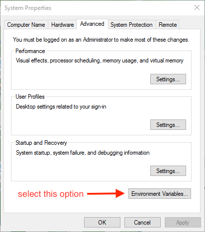

Unfortunately, according your %temp% variable the temp directory is located in the Windows directory, which is and should be read-only. I have a hunch that bad %temp% definition is the problem. Most apps use those environment variables to find those directories, that's so they can be relocated in case your system requires. Thus, the "default" location is not guaranteed, and if the TEMP and TMP (TEMP is the more commonly used one) is not set correctly, it can cause issues.
There are two sets of environment variables on your system: the SYSTEM environment variables and the LOCAL environment variables. I'm guessing that your local TEMP var is missing and that your system TEMP var is mucked up ("Windows/temp" is badly formed). Or it could just be that your local TEMP is badly formed. In any event, you need to correct the problem and reboot your computer.
In the Windows 10 "search" bar, type "environment" (without the quotes) and select "Edit the system environment variables" from the list that appears. If my list (shown below) does not appear, try searching for "system environment" or "edit the system environment."
Then, in the "System Properties" dialog that appears, push the "Environment Variables..." button:
Then, fix whatever is wrong so it looks like what you see below. You'll have to select a specific variable, click "Edit..." and make the appropriate changes. What I'm showing below came directly from a fairly fresh Windows 10 install and is also what you will find on a Windows 8 and Windows 7 machine.

wow!! tons of thanks!!! it worked finally!!! you r my hero paul! :)

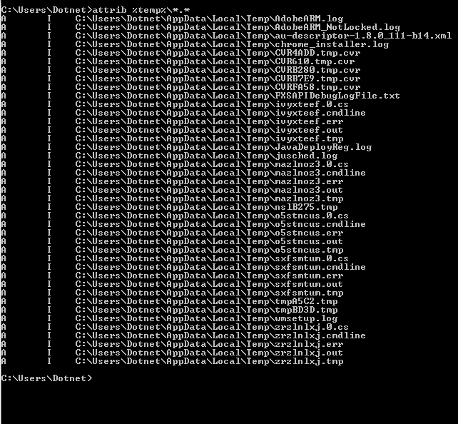

I have the same issue, initially it was working fine then on creating new projects it showing the error "Error creating project: Error copying tmp directory contents to project: Could not copy directory: C:/Users/Dotnet/AppData/Local/Temp/tmp-4452Y9nc279hHAUc/unzip/templates" as mentioned in this thread I have checked the temp folder location and following is the result. It will be very helpful if someone has any solution for this.

Sudheshna -- several others have reported similar behavior, but I do not recall what their solutions were. I recommend you exit the XDK and then clear the XDK temporary folders and try again. Instructions here > https://software.intel.com/en-us/xdk/faqs/general#recover-xdk < on how to "clear Intel XDK's program and cache directories and files" on your system.
Sudheshna_K_
23,248 Views
Hi Paul,
It worked fine. Previously even reinstalling the instance didn't work thank you very much
