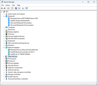

KingGoddard

Cool, yeah I've tested the intel be200 with Linux and Windows and it doesn't work on either(with AMD).

 @KingGoddard - Windows 11 finds all three radios, but it'll be a few weeks from now before I get to throughput test it against a WiFi 7 AP (Asus BQ16) - https://www.asus.com/uk/networking-iot-servers/whole-home-mesh-wifi-system/zenwifi-wifi-systems/asus-zenwifi-bq16/ (But connecting to WiFi 6 access points (Asus XT8) the BE200 is very reliable.)

31,896 Views
I see, yeah on AMD systems for Windows device manager shows it as without a driver.  On Linux bluetooth works, but not Wifi.
