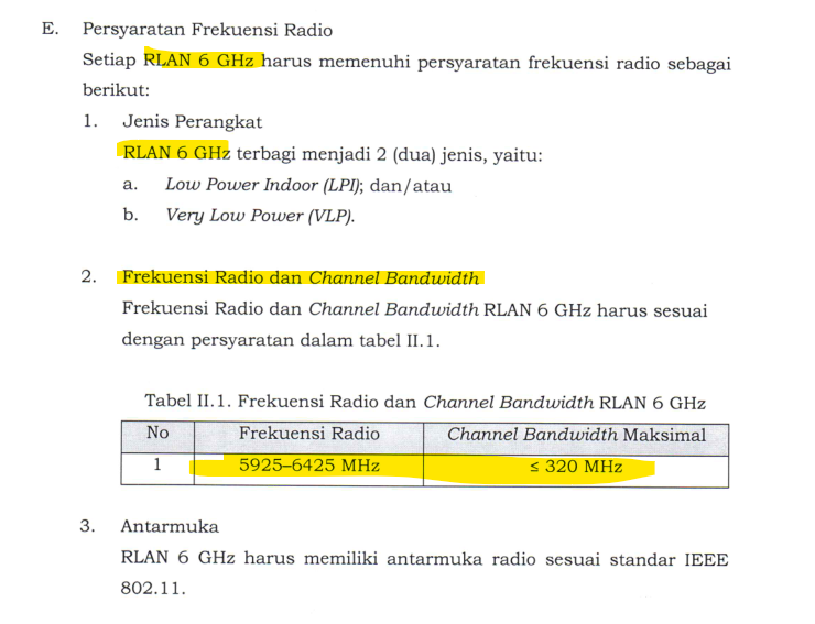

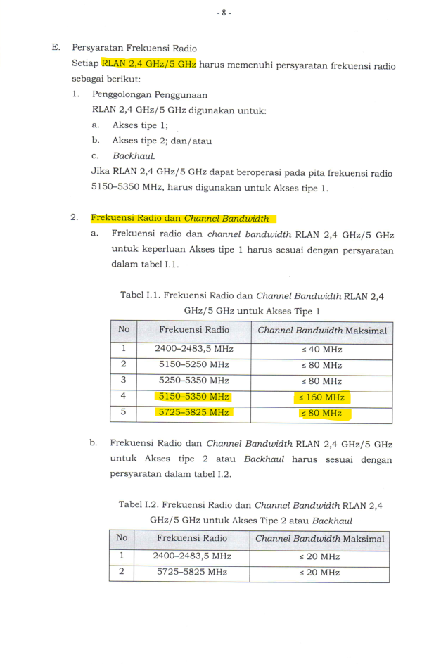

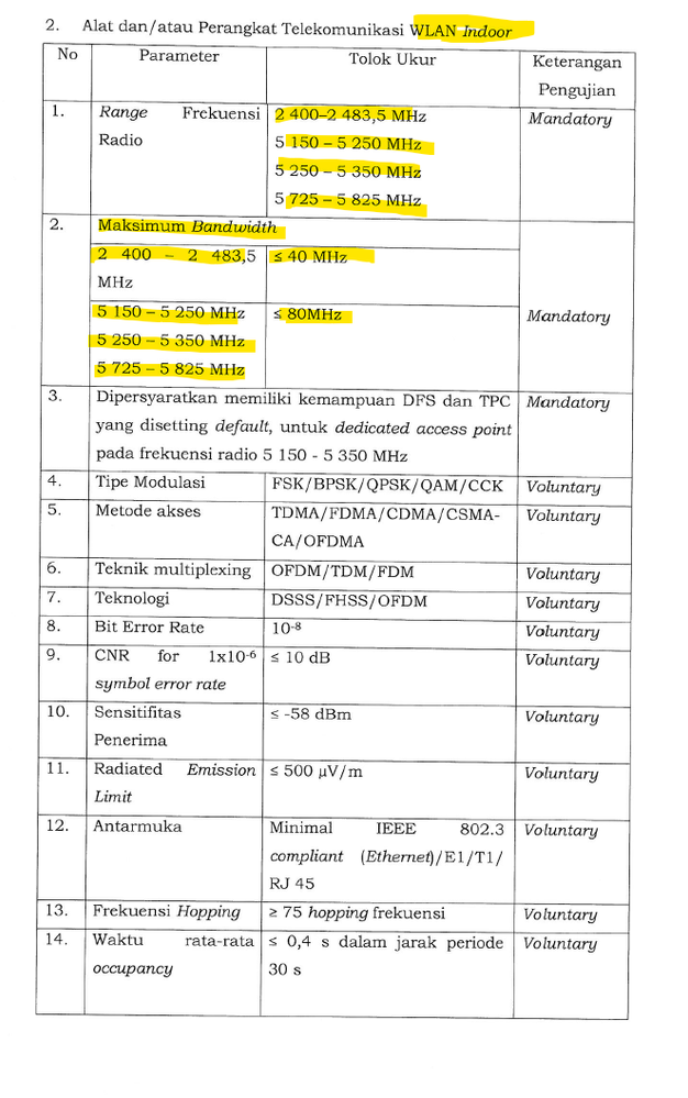

The Ministry of Communications and Informatics (Kominfo/Komdigi) have revised their regulations on Directorate General of SDPPI Regulation No. 2 2019 on Technical Requirements for WLAN Telecommunications Devices back in May 2019, permitting the usage of spectrums 5150-5250MHz (5GHz channels 36-48) and 5250-5350 (5GHz channels 52-68) for 5GHz Wi-Fi use in Indonesia. And it seems the AX200 still hasn't complied with the new regulatory specifications, thus seem to explain why I can't connect to my 5GHz access point on channel 36.
Here's the link to the authoritative source in Indonesian: https://www.postel.go.id/downloads/42/20200418142416-perdirjen_2019-02_WLAN.pdf

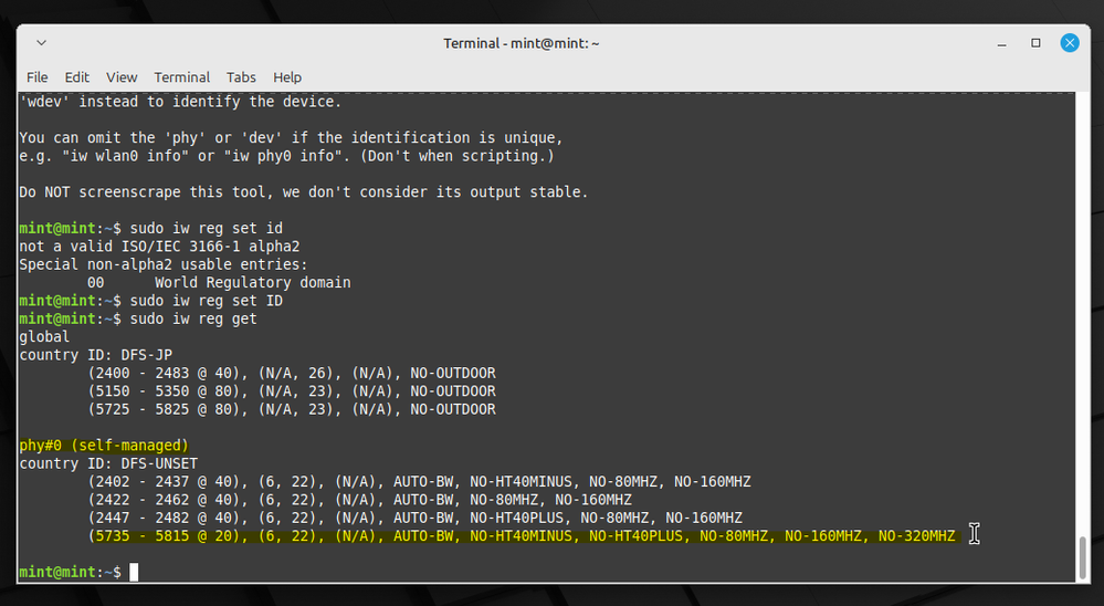

I should also add the fact that I've contacted TP-Link themselves and had one of their technicians to help troubleshoot with an Intel ANT debug tool, and temporarily changing the card's regulatory mobile country code (MCC) to US or Australia seems to fix the problem temporarily before it reverts back in two hours. The problem recurred again when reverting the card's MCC region back to Indonesia, which indicates that there's a problem with the region code ID for Intel wireless cards that makes it refuse to connect to access points on channel 36-68.
Running the command iw reg get on iw on Linux Mint seems to confirm this even further.
The global info for Indonesia on iw indicates that it supports 5150-5350 (channels 36-68) on 80MHz, referring to the 2019 RLAN regulation set forth by the Indonesian Ministry of Communications and Informatics (Kominfo). But the wireless card itself (phy0), only supports 5735-5815 (channels 149-161) on 20MHz.
I should also add the fact as well that in the years since, Kominfo and the Indonesian government has recently allowed 5150-5350 up to 160MHz back in 2023, and then recently allowing 6GHz Wi-Fi on 5925-6425 up to 320MHz channel width back in February this year.
With computer stores selling and OEM laptop manufacturers now including Intel AX210 and BE200 wireless cards in Indonesia, I can imagine people will be very confused finding out that their 6GHz-compatible laptop doesn't work with a 6GHz access point in the future.
I hope there could be a regulatory update for these Intel wireless cards in Indonesia that not only adds support for channels 36-68 access points on the 5GHz spectrum, but also expands to recently allocated 6GHz Wi-Fi spectrums.
