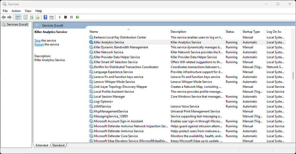

I finally got it installed. But now I have another problem.....I installed the Killer Performance Suite but I cannot get it to display the download and upload speeds.

I downloaded the Killer Performance Suite version 36.24.831 and still cannot get the download and upload speed in "Current Network Traffic" .  I have reached out to both intel and Asus for help but they just put me off.

I have also updated to version 36.24.831 and network traffic is working fine.

Make sure Killer services are running.

I have went into services and made all Killer automatic and running.  I have the same problem with intel DSA and SSU not recognizing the Killer app.
