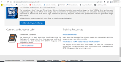

I am trying to run the python script from this repository.  First, it showed TensorFlow module is not found then I tried to activate the environment. I am getting the below error, please help me with this.

From the attached screenshot we could see that you are using Intel DevCloud for Edge for running oneAPI samples. You are getting error due to this. You need to use Intel DevCloud for oneAPI to run the Intel oneAPI samples. You can use the below link to enroll for Intel DevCloud for oneAPI :
https://devcloud.intel.com/oneapi/
If you have any further issue, please let us know.

Sorry for the late reply, I was busy with my course schedule. Can you help me with how to get the Intel OneAPI Jupyter notebook?

To access Intel DevCloud for oneAPI using JupyterLab. Please follow the below steps after creating Intel DevCloud for oneAPI account:
Please find the below screenshot for reference:
If this resolves your issue, make sure to accept this as a solution. This would help others with similar issues.
