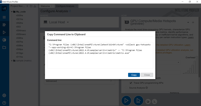

If you want to run vTune(CUI) using vTune(GUI) settings. You can follow the below step:
1. Configure the analysis with which you want to profile your application.
2. Click on the command line option (Highlighted in the screenshot below)
3. You will get the command line code for your analysis type (check the below screenshot)
4. You can run Vtune CLI using those commands
If this resolves your issue, make sure to accept this as a solution. This would help others with similar issues.
Thank You!
