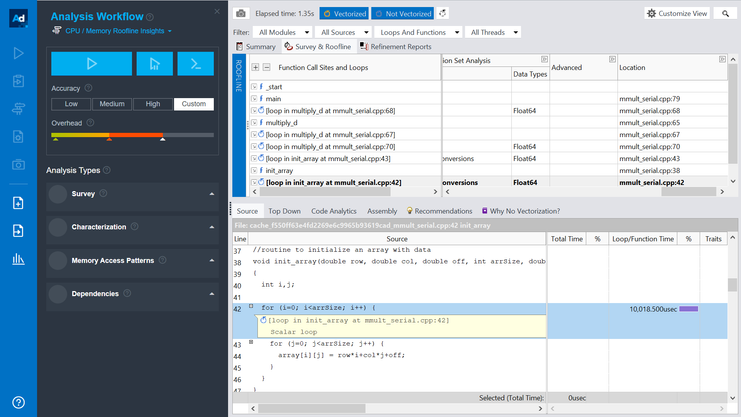

I see the survey roofline analysis too now but the source location, where I'll find the file name and line to add vectorization recommendation isn't available for any of the loops and function calls. When I click the source tab it says I should include cache sources option which i did when collecting the analysis and when taking the snapshot (--cache-sources included in both CLI commands).
Its the only issue now please, to see the location of the loops and function calls.

Please use the below command for creating the snapshot.
advisor --snapshot --project-dir=./advi_results --pack --cache-sources --cache-binaries -- ./bin/myApplication
We are able to see the location of the loops and function calls with the above command.
Please let us know if you face any issues after following the above steps.
Thank You.
This is what I used;
advisor --snapshot --project-dir=./~/o1/ --pack --cache-sources --cache-binaries -- ./snapshGOMC1
It's clear they are similar except the directory I output my result into. I'll run another survey analysis and take a snapshot with exactly
"--project-dir=./advi_results"
Also, can you rather show the source location from my snapshot? It seems your latest screenshot is from an analysis of Matrix_mul instead.
