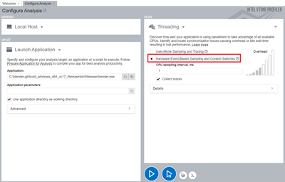

A freshly downloaded 2023.1 version of vTune exhibits the following assertion on 2 different devices I've tried:
Assertion failed: find_pyobject_offsets:50: 0 : Offset of field of struct was not found (frame.f_lasti). Please contact the technical support.
The initial "Performance Snapshot" works fine. However, none of the other analysis types after that seem to.

Kindly try using hardware event-based sampling while performing the analysis. Use the checkbox Hardware Event-Based Sampling/Hardware Event-Based Sampling and/or Context Switches to resolve this issue while performing Hotspot/Threading or any other kind of analysis.
Hardware Event-Based Sampling should be used when the profiled application which collects the following information:
(Hotspots) Profiles shorter than a few seconds
(Hotspots/Threading) Profiling all processes on a system, including kernel
(Threading) Analyze applications that incur significant tracing overhead
(Threading) Measure an impact of thread preemption and context switching
See configuration panes for successful analysis here:
Hotspots Analysis:
Threading Analysis:
The successfully profiled screenshots are also attached for reference:
If this resolves your issues, kindly mark this as a solution as it will help others with a similar issue. If not, do get back to us so that we can assist you better.

Thanks for providing the detailed steps for reproducing the issue. We tried compiling Blender for Windows using a machine with the following configuration and were able to replicate the issue from our side.
CPU: Intel(R) Core(TM) i7-8665U CPU @ 1.90GHz  2.11 GHz
OS: Windows 10 Enterprise 22H2 19045.3086
Visual Studio: 2022 Professional (17.5.2)
Error Screenshot:

Yes, using Hardware event sampling seems to work.  This is a pretty bad user experience.  A better error message and logging would have prevented 15 days worth of effort to resolve...

We raised your concern with the development team who informed us that this was a known issue with User-Mode Sampling on older version of Intel VTune Profiler. This has been resolved on the latest Intel VTune Profiler version 2023.2.0.
