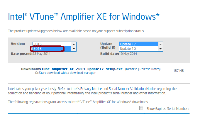

Do you know where I can get a 2013 installer? I googled for it but failed to find it.

Peter_W_Intel
1,909 Views
Searching google is not right way to get 2013 version, you have to access https://registrationcenter.intel.com/RegCenter/Register.aspx and login with your registered mail box with password.
https://registrationcenter.intel.com/RegCenter/Download.aspx?productid=2212 is VTune(TM) Amplifier XE product for downloading (if you have registered the product), you can select 2013 version for uninstallation purpose.
