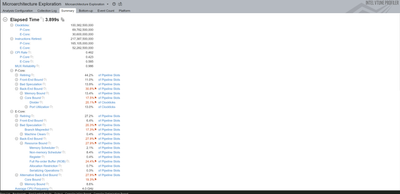

I am currently using VTune 2023 to do a microarchitecture analysis,  but found there is no µPipe diagram shown in the result. May I ask if there might be something wrong in my configuration or this is expected behavior in VTune 2023? Or is this expected for Big-Little structure CPUs?
Update:
I have tested on an old laptop with 4th gen Intel CPU and it does show the µPipe diagram.
On the computer with 12900HX, Hyper-V, Hypervisor Platform, SandBox, WSL, Virtual Machine Platform are all disabled; Hyperthreading and E-cores are disabled; memory integrity is turned off. Still, I can't see the µPipe diagram.

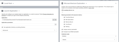

Settings Attached:

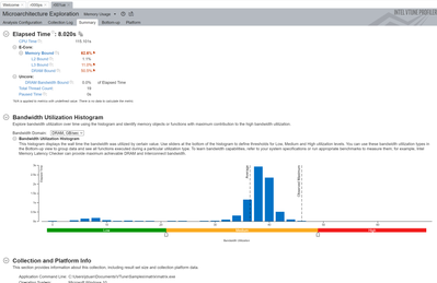

Result Attached (Memory Usage):

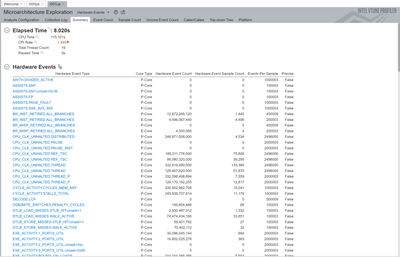

Result Attached (Hardware Events):
Result Attached (Microarchitecture Exploration):

We are sorry to inform you that VTune doesn't show uPipe for hybrid platforms, because for hybrid platforms we need 2 pipes. Due to weak demand for pipes we decided not to do it and have no plans to do it in future.
All the metrics: retiring, core bound, memory bound, bad speculation, and frontend bound that are visualized in the uPipe diagram can be seen in the summary tab of Microarchitecture Exploration output.
