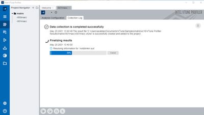

Hello!
I downloaded intel VTune profiler and when running the Memory Access profile and finalizing, it gets stuck in "Resolving information" for variant symbols (dxgkrnl.sys, ntoskrnl.exe...), even with the "matrix" sample or an empty c++ visual studio 2019 project.
Any help please?

Hello! The  "memory access" analysis fails even with the matrix sample.
I attach my windows system summary and the vtune self checker log (which was successful).

acaldas
11,273 Views
I have latest version installed... I cannot click on Refinalize while it's stuck. I'm attaching a screenshot of the matrix sample analysis.
