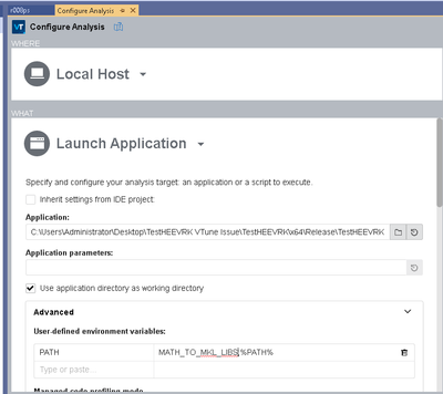

  When launching MS VS via Icon
  Building Release build app with MKL threaded
  Start Without Debugging
Program runs (finds mkl_intel_thread.dll)
  Then when attempting to VTune without changing anything in MS VS
Program fails (unable to find mkl_intel_thread.dll)
The work around:
Launch Intel Parallel Studio intel64 cmd prompt
     devenv mySolution.sln
It would be nice if VTune would inherit the environment as does the debug/run does.

I managed to build the "TestHEEVRK" solution. It appeared that VTune Visual Studio Integration doesn't take Environment variables from the project settings. (I mean this env variables: " OMP_PLACES={0:64}...".) The fix for the issue is created and will be added to the future VTune releases.

Hi Jim,
I've investigated deeply the issue with missing with mkl_intel_thread.dll. Fortran Visual Studio integration extension sets runtime environment variable to MKL libraries. There is no way for VTune VS extension to retrieve the environment. The workaround is to set environment to MKL libraries manually in VTune Configure Analysis tab:
The fix for retrieving environment from project settings will be included in future VTune release. So ways of workaround will be available.

This issue has been fixed in the latest release of VTune Profiler (version 2021.3.0)
If you do not want to upgrade to the latest version, you can use the workaround by setting the env variables manually in the Configure Analysis tab in VTune.
