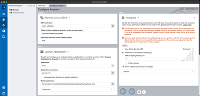

VTune installed in a remote Linux system. vtune-self-checker.sh seems to indicate that the SEP driver is loaded and functional (see attached log.txt).
Tune GUI running on MacOS and connecting via SSH to the remote Linux machine return the following errors:
x This analysis type is not applicable to the system because VTune Profiler
  cannot recognize the processor. If this is a new Intel processor, please
  check for an updated version of VTune Profiler. If this is an unreleased
  Intel processor, please contact Online Service Center for an NDA product
  package.
x Cannot enable Hardware Event-based Sampling due to a problem with the driver
  (sep*/sepdrv*). Check that the driver is running and the driver group is in
  the current user group list. See the "Sampling Drivers" help topic for
  further details.
The processor in the remote machine is Intel(R) Xeon(R) Silver 4210 CPU @ 2.20GHz
Any help would be appreciated.

To Check the issue from our end could you please share the MacOS processor details?
We could see that you have mentioned like the processor in the remote machine is Intel(R) Xeon(R) Silver 4210 CPU @ 2.20GHz (Cascade Lake). But in the log file it is mentioned like skylake.
Could you please verify and confirm the same.

I've tried multiple systems with the same result, which is why you saw more than one target processor. Sorry for the confusion. For the purpose of this thread, we can focus on the Skylake use case.
The VTune GUI is running in a M1 machine.

I'm including a screenshoot of the GUI in MacOS(M1) GUI for your reference

 From your log we could see that:
"HW event-based analysis with stacks... Command line: /opt/intel/oneapi/vtune/2022.4.1/bin64/vtune -collect hotspots -knob sampling-mode=hw -knob enable-stack-collection=true -r /tmp/vtune-tmp-carlos_o/self-checker-2022.11.10_18.14.54/result_ah_with_stacks -data-limit 0 -finalization-mode none -source-search-dir /opt/intel/oneapi/vtune/2022.4.1/samples/en/C+/matrix/src – /opt/intel/oneapi/vtune/2022.4.1/samples/en/C+/matrix/matrix Stderr: vtune: Warning: Access to /proc/kallsyms file is limited.
Consider changing /proc/sys/kernel/kptr_restrict to 0 to enable resolution of OS kernel and kernel module symbols. vtune: Warning: To profile kernel modules during the session, make sure they are available in the /lib/modules/kernel_version/ location. vtune: Error: Insufficient limit for open file descriptors in the system for driverless collection.
To increase file descriptor limit,
1. Set a value above (150 * logic CPU count).
2. For the attach mode, check if /proc/sys/kernel/perf_event_paranoid is set to 0 or -1. If yes, multiply new limit by number of threads in the process.
3. Set hard and soft limits to new limit with 'nofile' value in /etc/security/limits.conf.
4. Refresh login to apply changes."
See the last bullet in https://www.intel.com/content/www/us/en/docs/vtune-profiler/user-guide/2023-0/hw-event-based-sampling-collection.html and https://www.intel.com/content/www/us/en/docs/vtune-profiler/user-guide/2023-0/microarchitecture-analysis-group.html or the Prerequisites in https://www.intel.com/content/www/us/en/docs/vtune-profiler/user-guide/2023-0/intel-xeon-phi-processor-knights-landing-targets.html
